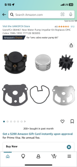

Ok thank you, where could I get a replacement water pump impeller? I have the original owners manual and also purchased the big one

I would need the model number of the motor to say with 100% certainty, but if you in fact have a 1988 2.3 motor, then yes. the 984461 part number would be the correct OMC part number for the water pump kit for that drive.
