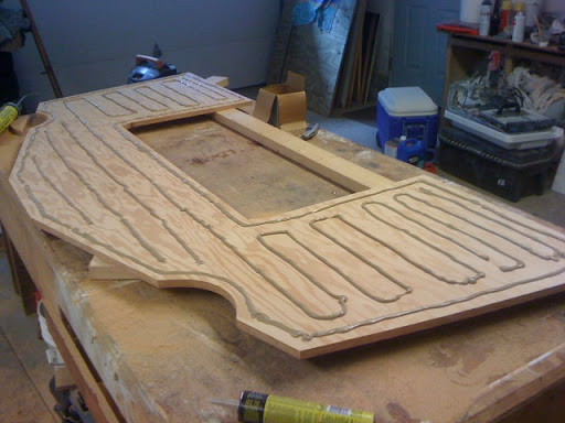

TRANSOM REMOVAL
So the transom has some rot on the passenger side about mid height. Talking it over with my dad he was leaning twords slammin fiber glass to it and calling it good. Spent a few hours reseaching on these forums and decided to attempt to pull the transom out.
Many, bolts, rivets, beers, and screws later, I have the well off and sitting on the floor, and the top sections of the transom removed. Pictures are kinda dark due to some late nights after work.
Really glad I decided to remove it, found quite a bit more rot directly under the center where the motor mounts covered on both sides by aluminum so I would of never seen it.
Going to remove the bottom section, trace, cut, glue/screw, west system, and install the replacement over this weekend.

So its been a hot 4th of july weekend in newengland but thanks to a ton of help from my dad the new transon is dry fitted in.
As you can see the spay foam was a wet mess in the back, all the water pooled at the back of both sides from sitting uncovered for 5 years and had no path to get to the drain.
I didn't have a bucket loader or any kind of major lift available like I've seen some others use on these forums, but i was able to come up with a novel idea of screwing a 4ft peice of 2x4 across the transom. Then i set another board across the 2 I-beams on the floor, and wedged the jack from my truck between them. I put a bunch of long screws in it, and then cranked away, and she pop'd right out.
Sanded and painted the inside of the aluminum while I could get at it, had minor surface corrosion in a few places but nothing major.
NEW TRANSOM

New Transom Continued
Doug fir A/B marine plywood 87.00 x 2 sheets, ouch.

Car jacks, well that is a great idea, nice! I didn't see what you were using to seal up that new transom but I can see that you had a pail/brush.

Real nice work in the transom. Novel way to get the old one out. I had a heck of a time with mine. Tried lots of stupid stuff first but a 2x4 prying at it from the inside was what finally popped mine out.

I put two coats of fiberglass on the transom, paying especial attention to the edges.
Going to hit some hardware stores today and see what I can round up for stainless steel bolts and screws, stripped out a few of the originals in the removal process.

The 2x4 brace actually helped hold the rotted transom from ripping apart also, i was worried it was going to be destroyed and i wouldn't be able to easily trace it. It bridged some of the really rotted parts so i was able to get screw's into what solid places I could find.

Transom is all installed, and well is back in the boat, gotta put the end caps and rub rail and stuff back on, will update pictures later.
