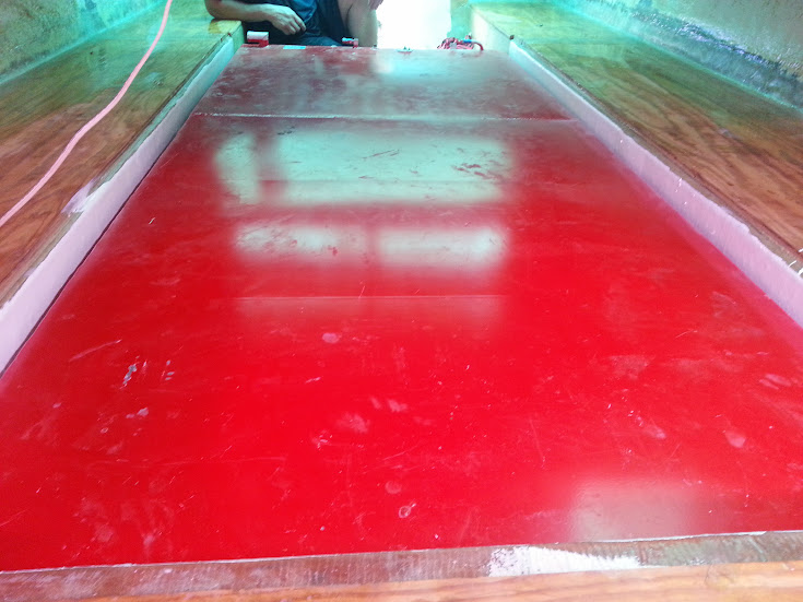

First coat of Bilgekote went down in the area where the fuel tank will live. Will need to recoat within 12-24 hours
The neoprene padding has been cut into 2" wide strips to be glued down with 5200 once the paint cures.

The neoprene is all glued into place:
Time to wrestle this massive fuel tank into position:
Back where it belongs, finally:
And we fabricated the sole section that covers the tank. It's 4' x 8' 6" of 22/32 plywood. 2x4 cleats are PL'ed and screwed to the underside. Each cleat is positioned directly over one of the baffles in the tank:
Once the PL has cured, we'll lay a layer of epoxy and cloth on the bottom side and give it a couple of coats of Bilgekote. A strip of neoprene will be glued to the bottom of each cleat.

And after two coats of Bilgekote:
Don't know if we'll get it hoisted up into the boat today or not. Need to make a trip to Harbor Freight to buy some boring household things and cash in some Father's Day coupons, then visit my father in the nursing home. Maybe mow the lawn if I get a chance. Oh, and take my family to a restaurant and pay for a meal in my honor :tongue:
Incidentally, this thing gets heavier and heavier! Not sure what it weighs now, but it's a bear to maneuver around.
