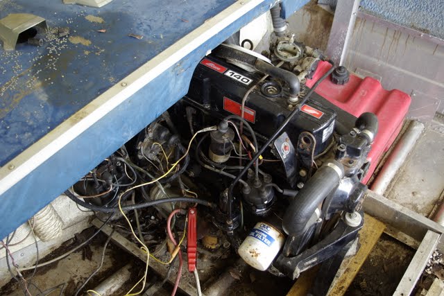

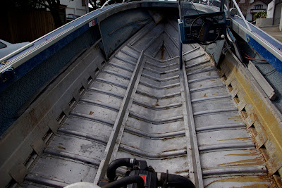

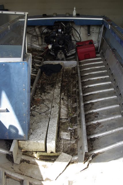

I picked this boat up in Livermore Northern California, not a whole lot of these boats around here. Paid $500, it was last registered in 1993. Is this a SS? It has a 140 Mercruiser I/O and open bow. The previous owner removed the floor. The motor has good compression and I almost got it to fire today, I'll put some new plugs in it and rebuild the carb and it should start right up. This is a great site with lots of good photos and tips for new Starcraft owners. I will post photos as I go.

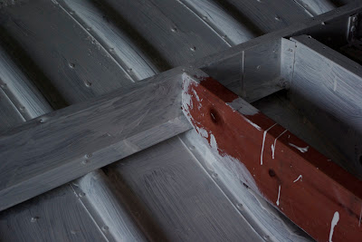

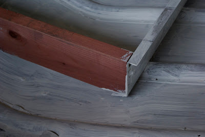

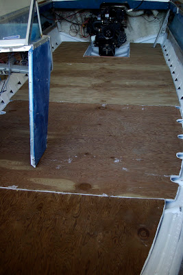

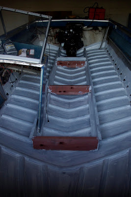

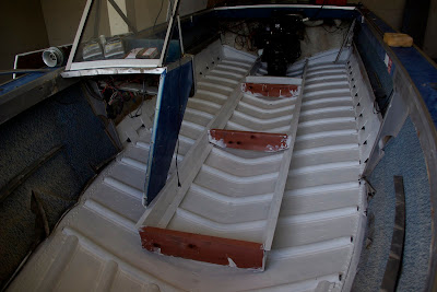

]I made some progress on the boat, started the engine, it runs pretty good once warmed up, I changed oil and filter and installed new plugs. The impeller is next. Since this boat will see some salt water around the San Francisco bay area I sanded and primed the inside of the hull with Kelly Moore aluminum primer. Rustoleum paint is a little hard to find locally here and Kelly Moore makes a good product. I used two coats, this primer does not need to be top coated. While these boats were designed to flex a certain amount I did add three redwood ribs where the pressure coated 1/2 ply seams butt together. I think it will give the floor a little added stiffness. Redwood is our version of yellow pine here in the west and is very rot resistant. I lagged the 2X6 ribs with galvanized 2" self tapping bolts. I also added a redwood bracket to the oak engine mount the PO installed so the engine will not flop around in rough conditions. I also found some of the M22 Benjamin Moore paint, it is no longer stocked in most places in California, I bought one gallon for 30 bucks and they had one left, I think I will get that one too. I plan on a white hull and grey stripe and trim, with white captains chairs. The floor is cut and ready for riveting and screwing. I primed the bottom of the pressure treat floor boards with kilz2. The hull is ready for prep, I think I will hold up the stern with a cherry picker and build a frame to hold the front up for sanding and painting.

Did you include flotation? How long do you think it will take for the pressure treated wood to react with the aluminum? ...... I bet one season in salt water maybe faster......

Karhawk, not tryin to rain on your parade here but you're gonna have problems with a couple of things here. First, the chemicals leaching out of the pressure treated wood are gonna attack the aluminum hull especially wherever you have fastened thru it. Secondly, anywhere you have galvanized bolts, they're gonna corrode to the point where they fall apart over time. If you plan on keeping this boat for any amount of time you need to correct those items.
Pressure treated wood and galvanized fasteners on an aluminum boat are big nono's.

Pressure treated wood and galvanized fasteners on an aluminum boat are big nono's.[/QUOTE]
Got it I'll change out the galvy fasteners with SS, since I have aluminum primer on one side of the pressure treat and kilz2 on the back side of the wood, is there still a problem with corrosion? As long as the aluminum has a barrier between the wood I should be OK?

Chris, I'm really not tryin to be hard on you here. Looks like you're doing a great job. The problem with the PT lumber is it comes to you with a very high moisture content as a result of the chemicals that are "pressured" into the wood to treat it. Sometimes you'll notice the liquid running out when you install a screw or nail. When you install fasteners thru the wood into your aluminum you provide a direct path for the chemicals to follow right to the aluminum.
Sorry to be the bearer of bad news but I'd rather you know about it now when it's at least a little easier for you to correct than after you get everything back together.
FYI, that primer is probably not going to stay on that pt plywood very long either.
