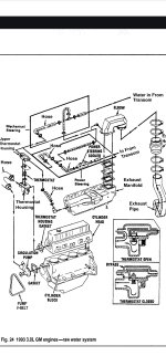

Page 463 of the Volvo Penta service manual shows the 98 model of the 3.0 has a hose to the riser from the thermostat block.

To add to the puzzle, it appears Volvo was making some various configurations for the 3.0 during the 90s. Here is the color cooling diagram, shows a version of the hose from the riser but this time to the exhaust itself.

And then a version plumbed to the steering cooler (mechanical or power). Good luck, interested as to which is most correct for your application/swap.
