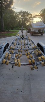

I did the conversion, and it came out great. Loading my boat is much easier and it goes on straight every time. I am going to sell the roller assemblies. They are all galvanized and would make a really nice setup for someone who wants rollers. Everything is included. just bolt them on to the cross bars of your trailer. I attached a picture of the setup before I removed them all. Yes they are wobble rollers.
