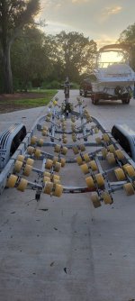

80 rollers doesn’t sound like a wobble roller setup. My 20’ Chaparral has 32 rollers on an EZ Loader trailer. My feet stay dry, lol.
They are factory Load Rite wobble rollers. Here is a picture of the setup before i did the conversion.
What an awesome trailer. If they were set up properly to fit the boat's bottom, it should have been a breeze to launch and load.
Since your new bunks work to your liking, that's all that matters.
My goodness that’s a lot of rollers. You weren’t kidding. I agree, if set up properly that’s an awesome trailer.
