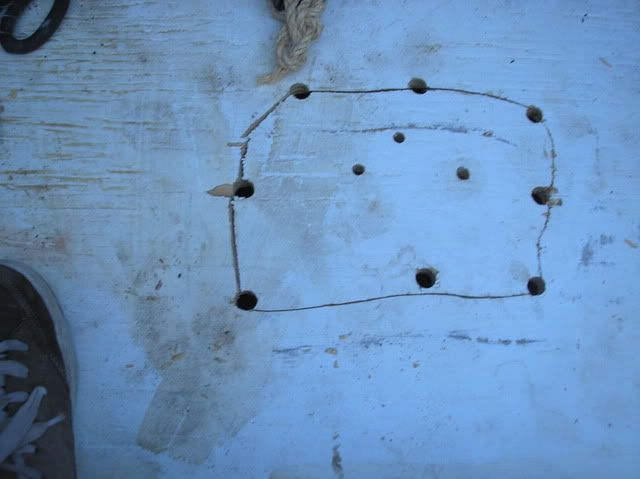

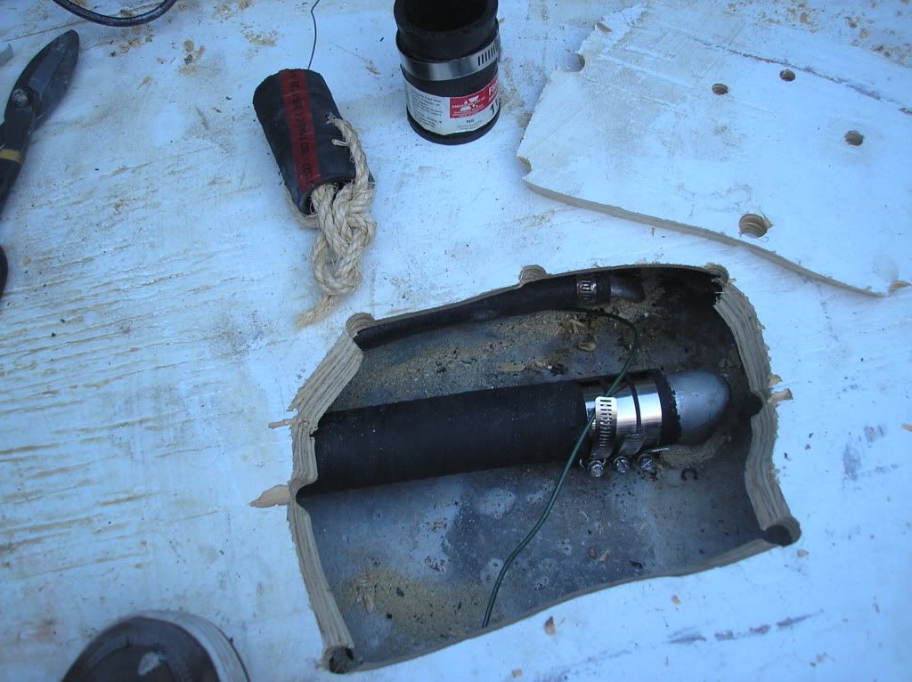

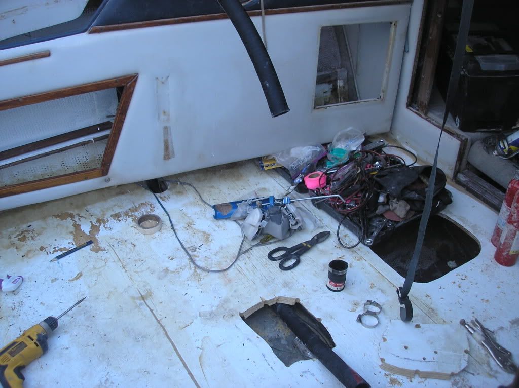

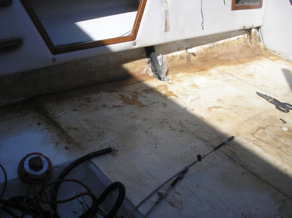

Installing new gas fill hose and patching the floor.
I used 3 layers of 1.5 oz cloth, each layer bigger than the one under it.
Cut at a 45 degree angle so the wood would lay back in nicely
Decided, no hatch.

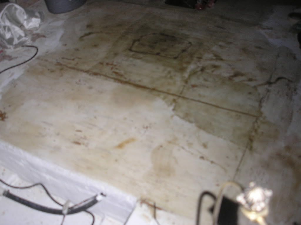

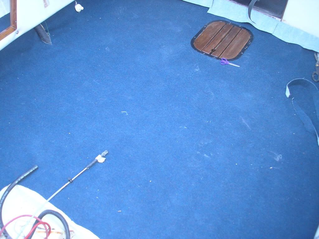

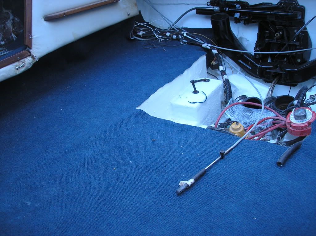

Haven't been feelin good lately, touch of the flu, but still managed to get some work done.
Two more layups to tabb the deck.
I know it's not the most popular choice but we went the the el cheapo carpet and it looks great. I covered the deck with a really thick layer of resin so it should hold up for a long time.
Still working on the detailing.

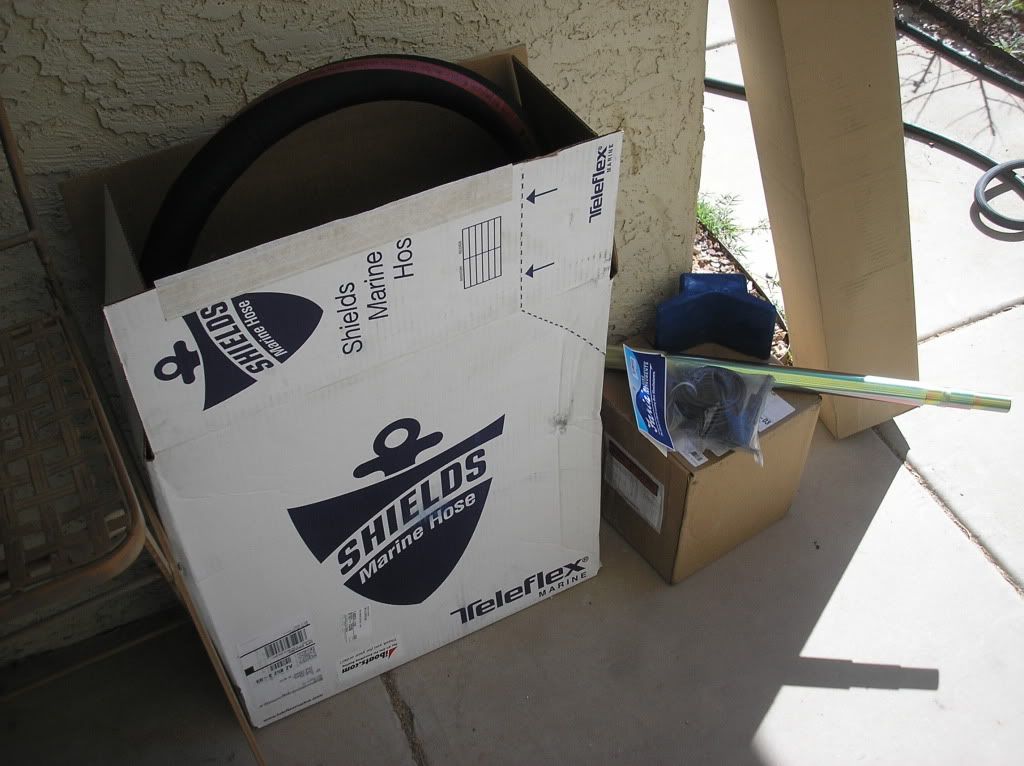

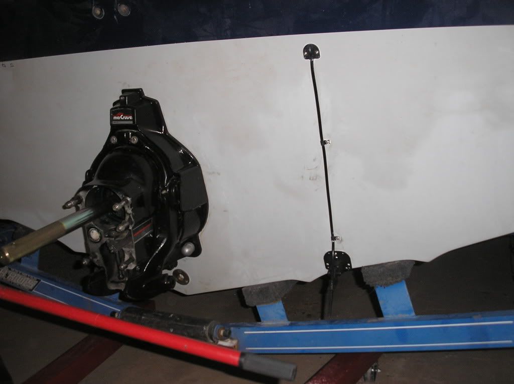

Put in a new speedo cable and pick up.
Also dropped motor back in and went in without to much trouble.

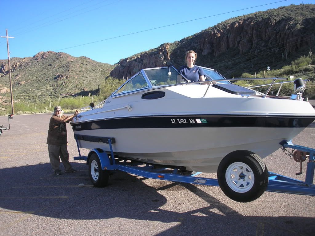

Splashed.
She runs great.

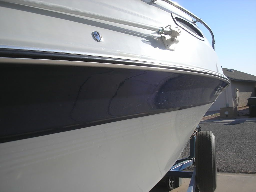

Removed all the 5 layers of pin stripes.
