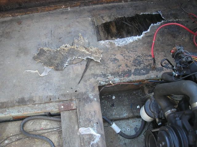

Here's some pics of where I drilled into the stringers.The stringers are hollow,I think they're all fiberglass. Is that even possible?

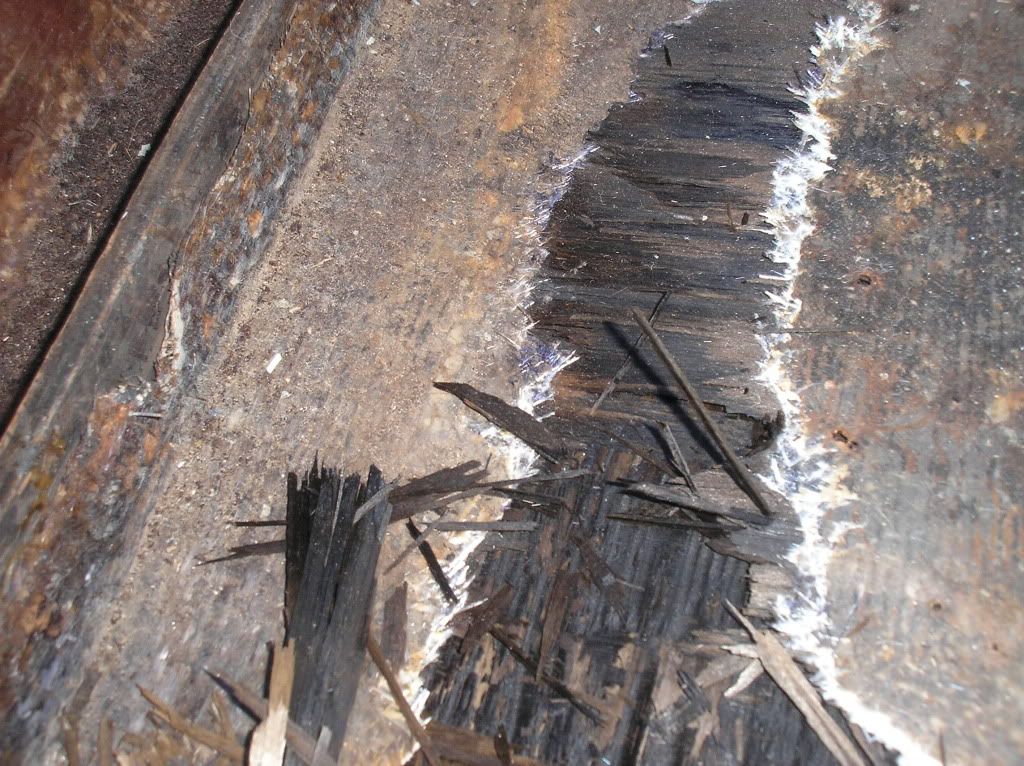

Pics of where I checked the foam to see if it was wet. I went down about 3 inches and it was dry.

.....woah.......nope.....when you check a transom........here is what you do....
you have an i/o motor....(inboard/outoboard) that means the transom is 2 ins thick.........take a drill bit......and place tape around the shaft of the bit at 1 3/4 inches from the tip.
this will give you a depth gauge (crude...but it works....just dont drill up to the tape.....rot will be all thru the wood if its there at all....so dont worry about the last 1/4 inch of wood next to the hull skin)
from the inside of the transom......drill holes up to your tape.....drill one near your garboard drain....and below any place where there is screw in the transom. that means toe hooks.,....speedo.....any place someone has drilled onto the transom....take a core sample from under that spot..
any hole that you drill....fill and seal with 3m 5200.
now....lets take a look at the wood shavings that come off your drill bit.......are they wet?....did the drill bit just go thru the layer of fiberglass (on the inside of the hull) and then punch thru thin air to the hull? look for coloring of the wood as well as wet. if its rot....it must come out.
now....as far as your stringers.....yes...they can be foam stringers.
what the manufacturer has done is just use the foam as a shape to glass over....the actual glass is the stringer.
now ....your choices with foam stringers are
1. rip them out and replace with wood.
2. leave them alone and fix around them.
3. add more glass over them for insurance.
personally i would choose to leave them alone....(if in fact they are foam and not wood that is rotten to nothing.) if they aint broke.....dont fix em.
remember......we tend to over think things....so just because you get it in your mind to rip out the transom, stringers and foam......if they are good....why do it?

I checked the transom today and I drilled my hole about 6 to 7inches away from the plug. Found that very little shaveings came out but the shaveing that did come out looked like compost.
I drilled a second hole on the port side under a hole that looked as if a screw had been their at one time. Dry shaveings their.
It's hard to tell from the pics
