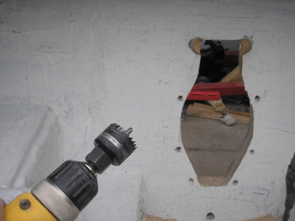

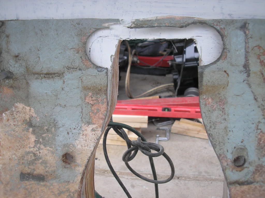

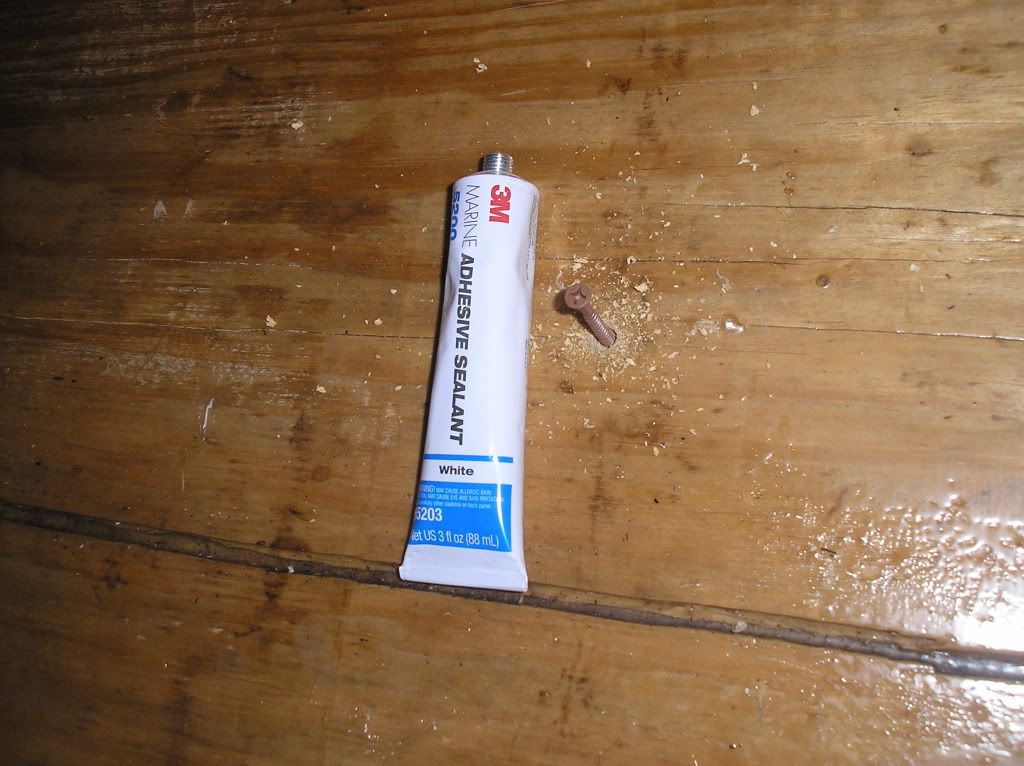

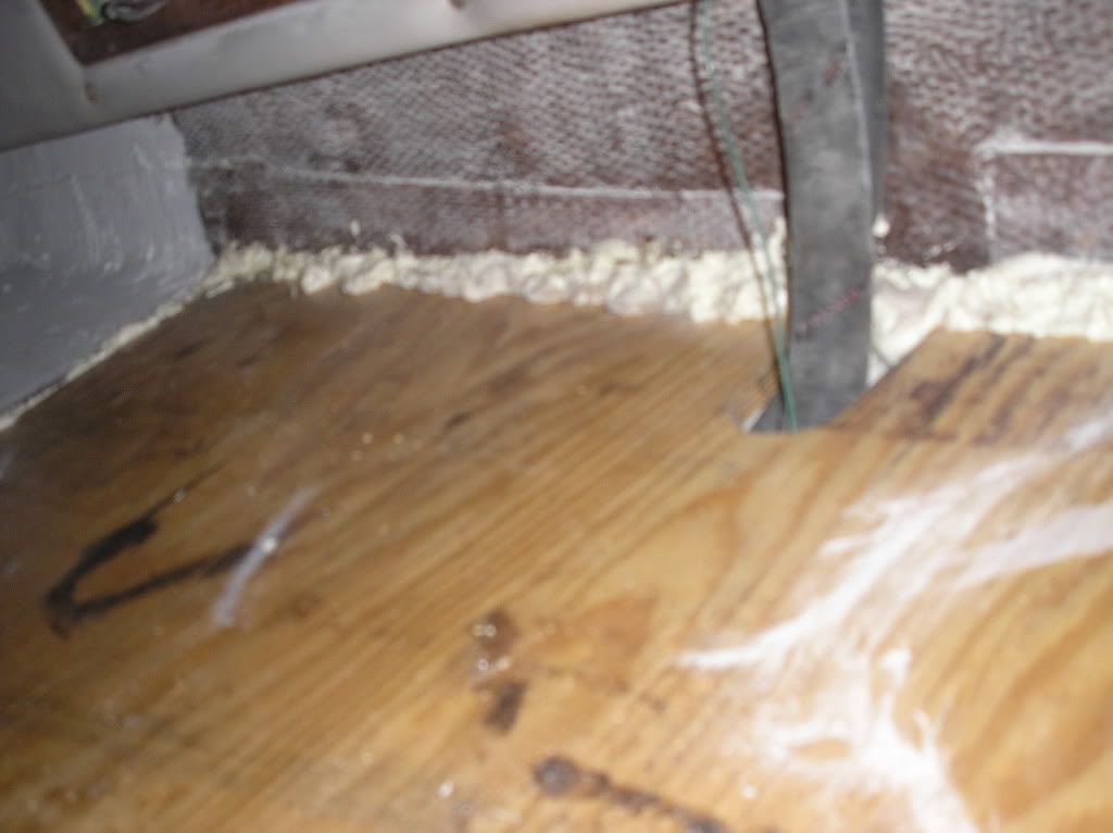

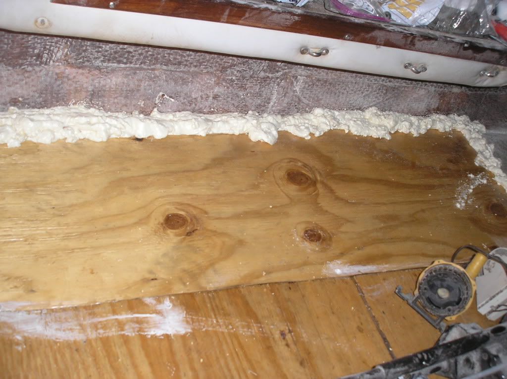

No pics of bilge and transom yet but I did get this done.
Cut out the rest of the deck.Covered both sides with a nice layer of resin. Didn,t glass it like I did the back to save a little time and $. Glued and screwd. Filled all holes and covered screws with 5200.

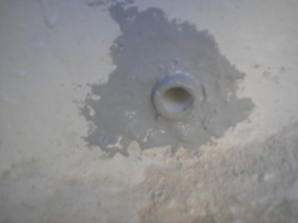

Cut and glued a piece of pvc in the drain hole in bilge. Thought that is better than nothing their at all. Their was nothing covering it to begin with I think that's were the water got in and caused it to rot.
Gaps between the deck and hull sides were larger than I liked so I filled it with foam. Tomorrow I'll test the foam and hope it doesnt dissolve when I cover it with resin. Still need to cut foam and shape it how I want it.
Heres some pics,

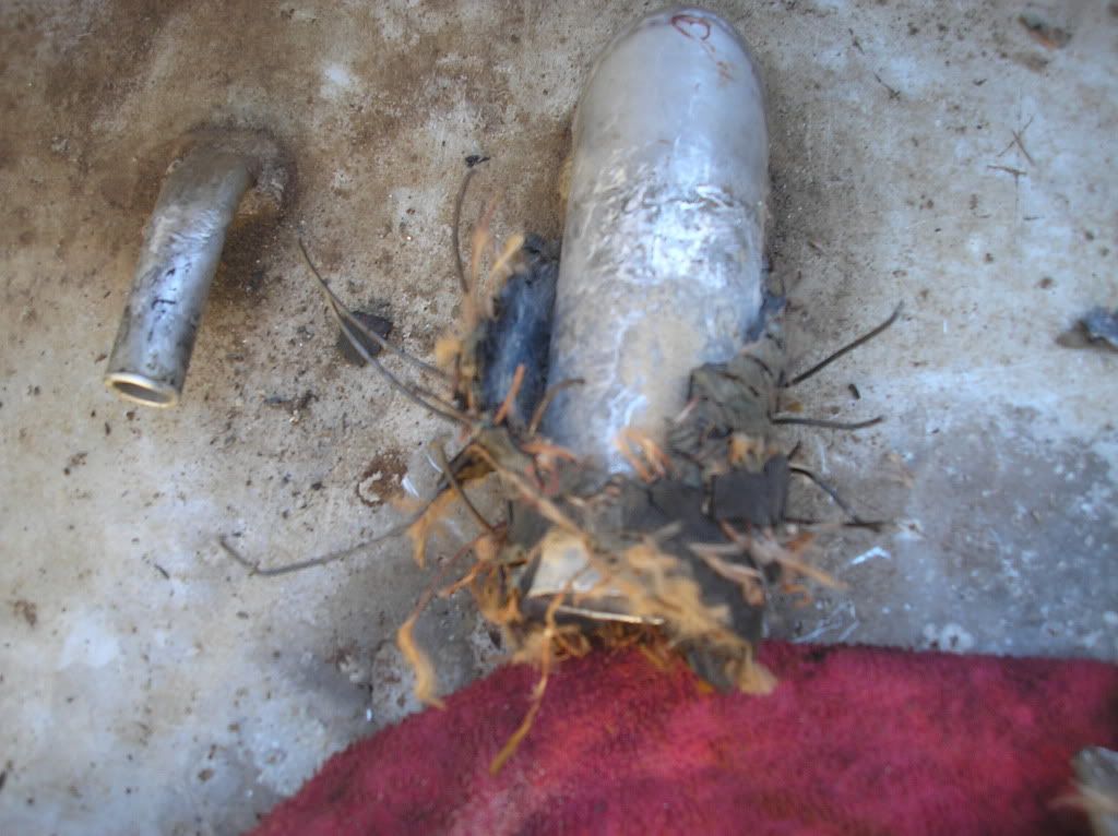

I also had to fix that gas line I cut. Hadto cut every wire to get the rest of it off the tank.I think it was glued.
New gas line runs about 75$ but I fixed her up under 15$.

So today I cut the foam and their was alot of air bubbles. I thought the quality of the foam would have been thicker. So I smoothered it in pl to try to seal it up. I didn't try to see if the resin was going to dissolve the foam but something tells me it would.
Deck is sealed and one coat of paint.Still need to sand 1 more time and 1 more maybe 2 coats of paint.

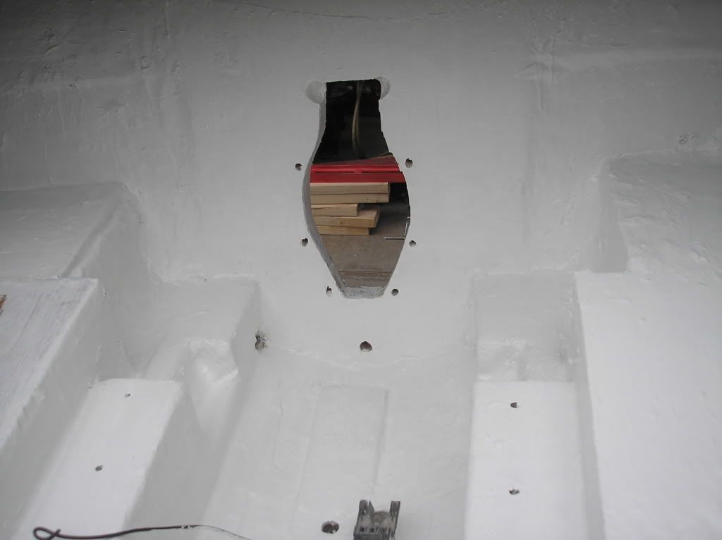

Got the gimbal bearing in, bellows are on. Gimbal and bracket and steering arm are in.
pics tomorrow.

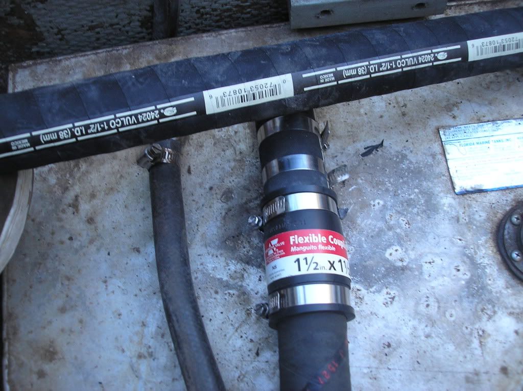

Is that a fernco coupling from the plumbing dept. at Home Depot?
produceguy
Sep 30, 2010
1,243
Re: Replaceing deck and transom on 88 Mach 1
I,m not sure what you call it but I did pick it up at home depot. The rubber looked thick enough, looked just like the hose. Please tell me I didn't screw up by putting it on :confused:
I would hate to have to cut out my new deck. :(
Bondo
Apr 17, 2002
71,417
Ayuh,... No way I'd use plain ole plumbing parts from HD on the Fuel system....
That IS the gas Fill hose ain't it,..??
It's supposed to have the tracer wire in it for bonding the fill spout to the tank, which is supposed to be bonded to the motor's block...
So long as everything is bonded, there's no static electricity, so No Boom....
