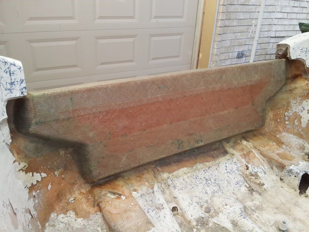

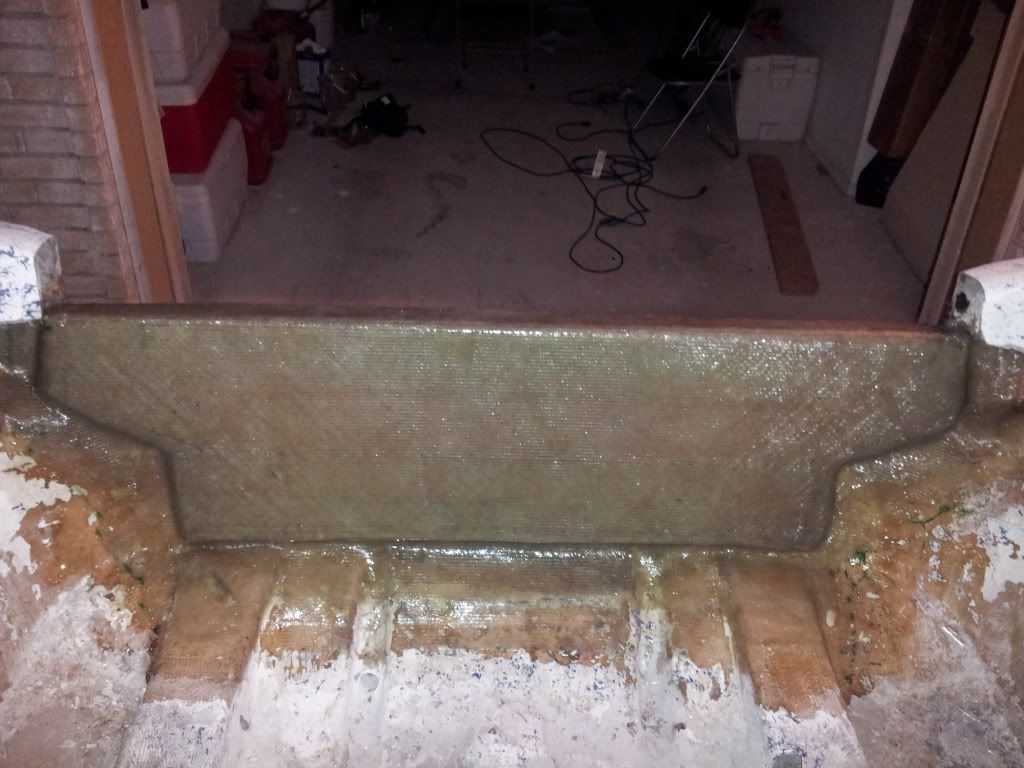

I have put on 2 layers of tabbing using 1708. Is that enough tabbing or should i put one more?
Woodonglass
Dec 29, 2009
25,932
Re: Rebuilding Transom and Stringers...
Your good. I'd sand and feather the edges and put on a full Layer of CSM followed by two full layers of 1708 6 to 8" overlap.
Captpacu
May 5, 2013
29
I put in one full layer of 1708 that overlapped the tabbing but didnt extend over to the hull, then i put in another full layer of 1708 that extended about 4in and then one more layer that overlaps 6"
Woodonglass
Dec 29, 2009
25,932
From where I'm standin, I'd say that's a darn good Transom installaton!!!

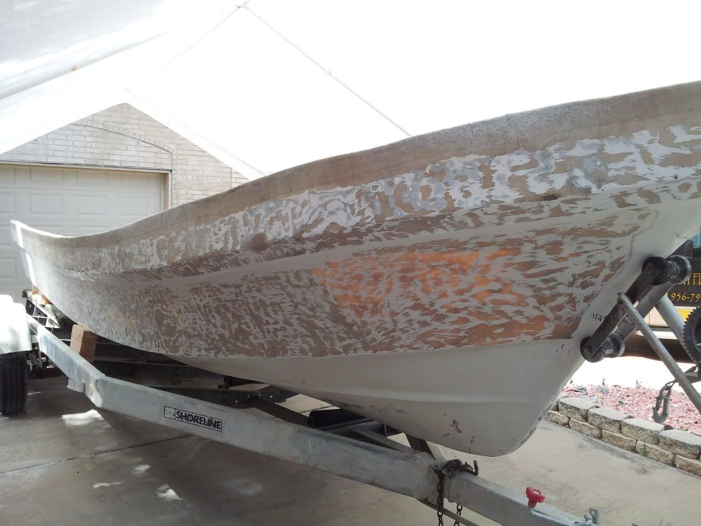

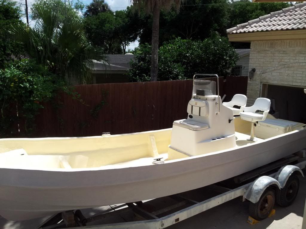

Well im moving on to the hull now... Going to start sanding it down and repainting. What would you suggest i do about sanding the boat? Should i just sand down the original paint a little and just spray on a new coat if the old paint isnt too bad? and if i have to sand down to the skin, do i need a different paint or primer?
Woodonglass
Dec 29, 2009
25,932
I always recommend using primer that's compatible with the final finish coat of paint. They work together to promote proper adhesion. Have you given any thought to what paint system you'll be using?
Captpacu
May 5, 2013
29
i have not. I was thinking of just sanding down the top layer and putting on a fresh coat...What product do you recommend. This boat will stay in the water for more than 3days some times...
Captpacu
May 5, 2013
29
I orderd some tuff stuff primer and cukote shark white bottom paint. Im sanding down to the fiberglass but im having a hard time getting to the bottom... maybe im using a sander thats not strong and fast enough. im using 60 grit. Maybe im not patient enough...:doh:
Woodonglass
Dec 29, 2009
25,932
What sander and grit are you using? I'd recommend a minimum of a R/O sander with 4o grit. As mentioned a 4 1/2" grinder with a rubber backup pad and 24 or 36 grit resin coated sanding discs should make short work of it. Make sure and wear a really good respirator and googles when sanding/grinding. Some of this paint dust can be highly toxic.
Captpacu
May 5, 2013
29
i am now using an angle grinder with 36 grit and its comming along faster...
ill go back with my sander and smooth out my work.
