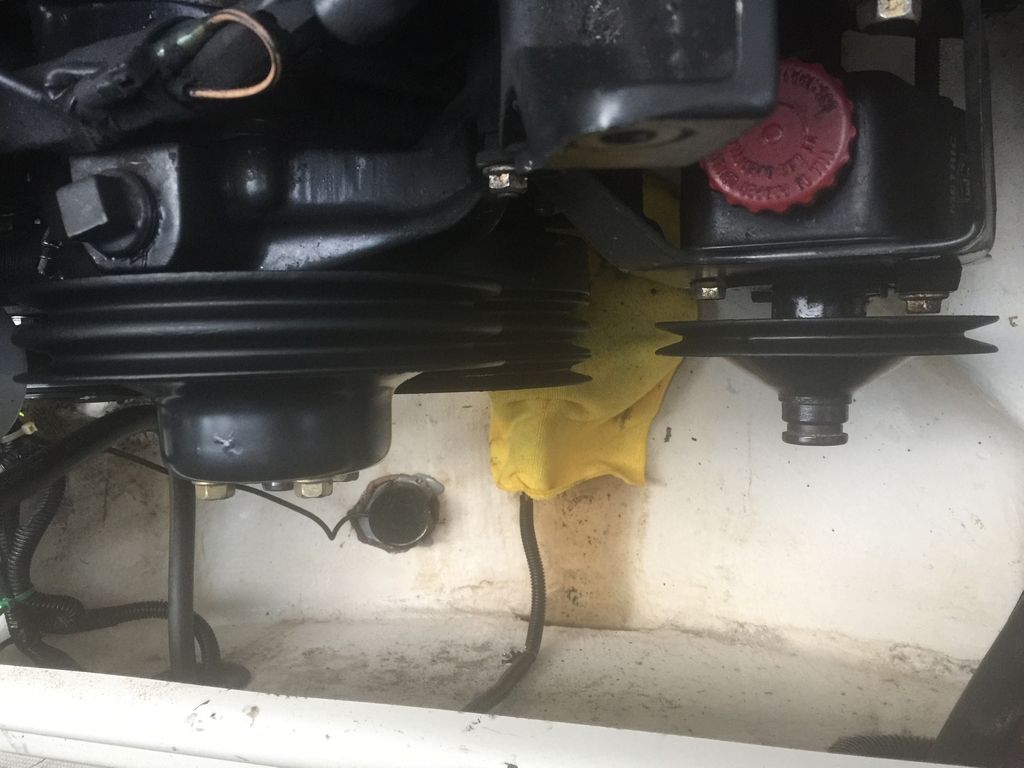

1,038
Hey guys, thanks for the advise and info above as always. So I finished up with the pulley's yesterday and I think they came out well. I used the POR 15 and top coated with rustoleum enamel flat black. Looks good, hope it lasts. We shall see.....
