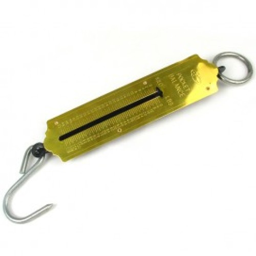

Had to mention it, for all I know, you could have used something like this hooked on the end of a wrench, :D
