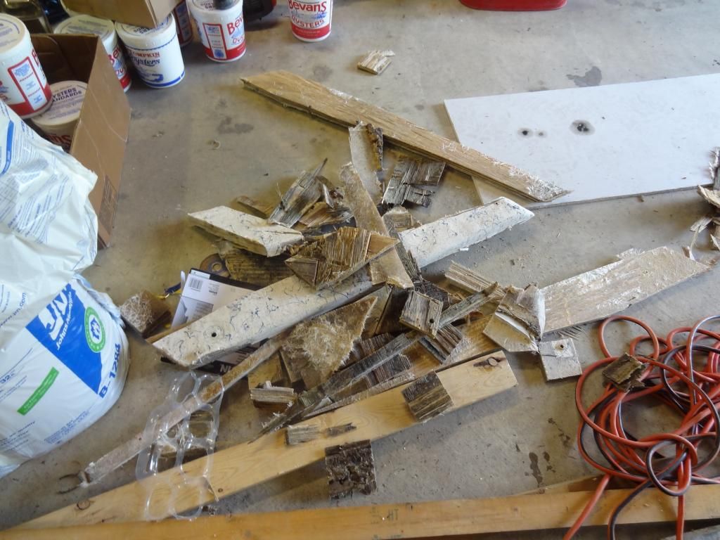

Welcome to iBoats! Pretty typical!! If you use a circular saw set to a depth just shy of the depth of the wood in the transom and cut the transom wood in a 1" grid pattern It'll be real easy to use a wood chisel to remove the wood from the glass skin. Have you core sampled your stringers??

It really, really helped me to work my way through the transom in smaller chunks. The guy in me wanted to pry it out in one piece.. Not gonna happen..
Sawing down and across in a grid will really make things move along after the edges of the glass are cut.. After I had the top out - the bottom finally broke freee and came out.

I finally got around to doing more work on the boat tonight and got transom out, thankfully in one piece so I have a template for the new one. I pulled lots of soaked foam out.
This thing does not have any stringers. It looks like just fiberglass ox with wood on top. I'm going to see if I can fabricate some stringers for extra strength.
