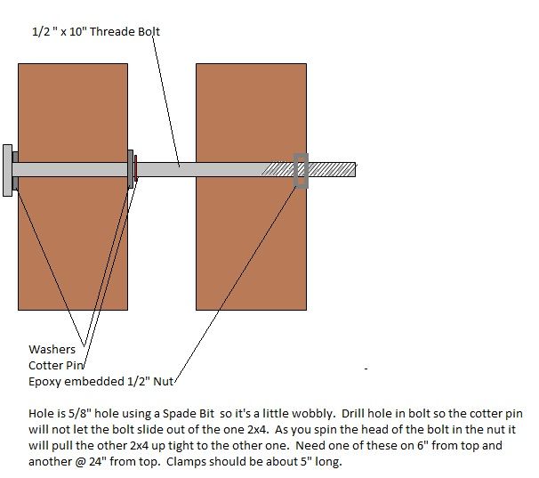

+ 2 on the transom clamps... Wood you should have a link to building them ? Yes?
