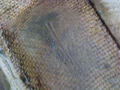

hey everyone sorry its been a while ive been busy with school and work but i finally took ssome pictures sorry if they arent the best pics

ok....yer gonna fix it.......lets rock and roll.
ok.....first....the rule of thumb is replace what was there.
in one pic....you have a stringer.....duplicate it on the other side.
....the hole in the hull is no problem.
but before i start typing a lay up schedule......
what kind of glassing experience do you have....that way i will know how to type it...

Ok, if you understand the Effort will be 80 to 100 hours of work, somewhere around $2k in costs, and you'll never get your money back then we are here for ya. When you're done she'll be good for at least the next 20yrs as long as you maintain her properly. The Crack in the hull is a straight forward fiberglass repair. Basically grind it down to good glass on the inside, wash it all down with acetone, tape some plastic over the outside, then lay a couple of layers of 1.5 oz CSM over the inside. First layer should be about 2 " larger than the crack, 2nd layer 2" lareger than the first layer. Then lay a layer of 1708 biaxial cloth thatst 4" larger than the last CSM layer Use Unwaxed Polyester Laminating resin mixed with 2% hardener and you'll be good to go. You'll do basicall the same thing on the outside.
Here's a pic of a finished repair similar to what your's will be like. Only problem with this one is I would have preferred the user do a bit more grinding on the old glass
