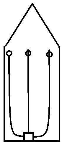

It is often something you need to decide for yourself: This is what you think will work, be feasible to construct & install, and satisfy your concerns.
I am on the fence, mainly for the fact that the foam will (in theory) expand to fill any compartment you pour it into, and adhere to any below deck surface it comes into contact w/. Filling the area & adhering to the below deck surface, makes it difficult to imagine water reaching a central flow channel or the bilge.
Trooper did the pourable foam, and used upside down 1/2 PVC pipes to create channels in his foam, directing water towards a central drain area back thru the bilge......
Others have done similar & different, all in an attempt to create a way for water to flow back to the bilge. I do not have any real help, sorry.
Your plan certainly sounds like a good one, as long as you make allowance for water to gain entry to the channel in several places along it's length.
