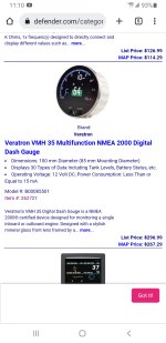

Thank you for the responses. If the MFD was a combo fish finder I could justify the price (in my mind 🙃) but I only would like engine data.
I did come across this: see picture.

It would work but looking at the docs its does way more than basic engine data.
I would be concerned with the "ease of use" of the HMI interface. Not a fan of "push button" menu structures
