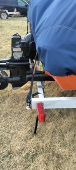

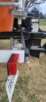

Note that the only thing contacting the back keel roller is the outdrive. Also note that the winch stand is very rusty... and is also ballooned, likely from water freezing after a noted "left in the rain for 6 weeks at a marina" incident 14 years ago. I wonder with a new winch stand/mount the roller contact point could be moved back to get the bunk ends and keel roller closer to the transom of the boat?
Reasons for wanting the change this is partially to make trailering/launching a bit easier (no need to dip the trailer as far), but also as a structural improvement (less stress on bunks) and to allow for full travel of the outdrive without bashing the keel roller.
Thankfully, the fender/axle assembly can be moved on the frame to allow for re-balancing of the tongue weight:
(It is attached to the main frame with U bolts)
The frontmost keel roller is also movable on the center beam... so that could be slid back the appropriate amount when the time comes.

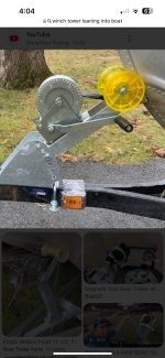

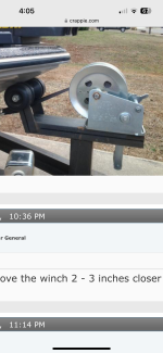

May have found something...
A bit rough, but the bones are there and it's correctly sized (for a 3" trailer tongue). Period and patina correct too. Obviously the winch and rollers are junk...
But more importantly, the geometry works out. Due to the way the tube is angled I can go past the gusset (not short since there is no flange) And the offset is misleading due to it being higher than I'd want/need; currently the upper roller is around 34" from the top of the tube (picture not clear, the measurements in the description don't match the picture); Based on what I'm guesstimating, it'll get me pretty close to optimal.
Sadly, the shipping cost is high (and right now I'm in a bit of a spending squeeze until I get the other trailer sold)... Not to say I couldn't copy part of the design and make some of it myself-notably, there are no weldments, just a 4x3 tube, a bent winch plate, and several flat stock braces. Heck, I could design something with a steeper angle and just add an off-the-shelf 3" winch mount... maybe that's the solution here?
Has anybody used a winch stand/mount like this? Is this solid enough?
