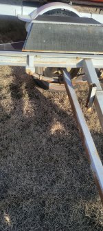

Per more research and pondering, I think I am seeing what happened with the axle... I'm suspecting it was originally an overslung setup, and somebody converted it to underslung. Explains the tight wheel and keel clearance.
So, if I fixed such (converted back to overslung), that would correct both issues. But, I'd lose some of my lowness.
The fun part would be seeing if drum brake flanges can be fitted (welded) to the axle... from what I'm reading, I'll want to farm that out due to the jig requirements (and also, it being somewhat safety related). And if not, maybe just put a new straight axle on it and be done.
Stinks that I'd loose some of the low riding, but the fender/step to boat clearances would still be improved. The goal here is to make things right... which means de-cheating things when it makes sense.

  • Something is up... there are rub marks on the inside of the fender. Definitely too low. And there is only 1" between the axle and the keel rollers per a check with a 2x4. Unsprung, the axle is higher then the lowest point of the V-bent frame tubes.
  • Flipping the axle will result in 3" gained in ride height. This excessive?
  • The spring seems a bit flat compared to most leaf springs I've seen. The rubber spring and shackle bushings are wasted... as is the rubber in the leaf bands. Sounds like the springs are shot as well?.
  • The axle can be flipped... spring attachment is 2 U bolts and the through-stud.
  • The axle is a 2x2 square tube. Can brake flanges be obtained in that size? Or new axle needed if I want to add brakes?

The only thing that comes to mind is the spring setup and if it is overslung or underslung. To help deduce where the issue is.
