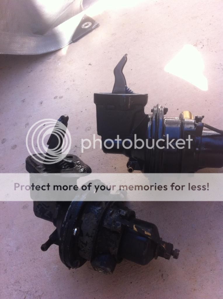

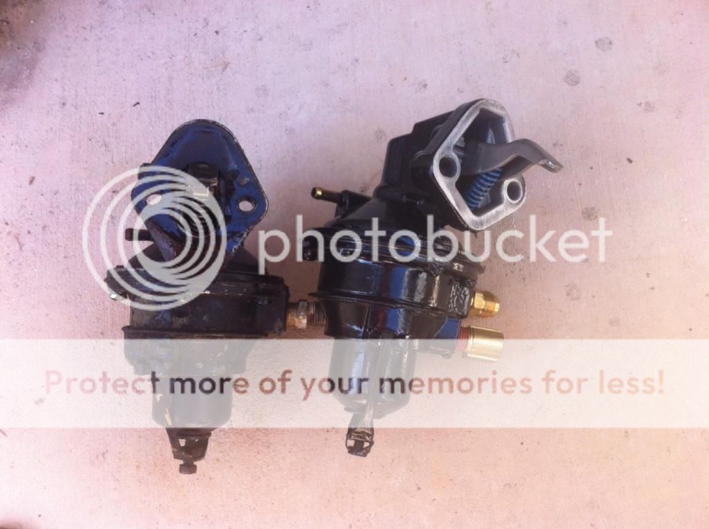

Have you held the old pump next to the new pump to check dimensions?
Here are some pics of the 2 pumps. There are 2 differences -- 1)the inlet and outlet are on the same side on the new pump and 2)the arm on the new pump is about 1/2" shorter than the old pump.

Ouch!!!! Yeah your photos are not coming through. Here are some 470 pumps from e-bay, which does yours look like? http://www.ebay.com/sch/i.html?_trk...w=mercruiser+470+fuel+pump&_sacat=0&_from=R40
The body looks similar to many of them, but the arm does not match any. It is pretty straight without the bend. I still can't post pictures. When I hot the "image" button it freezes up every time.
I will try adding as a link to photobucket.
http://i859.photobucket.com/albums/ab160/GJR3594/photo5.jpg
