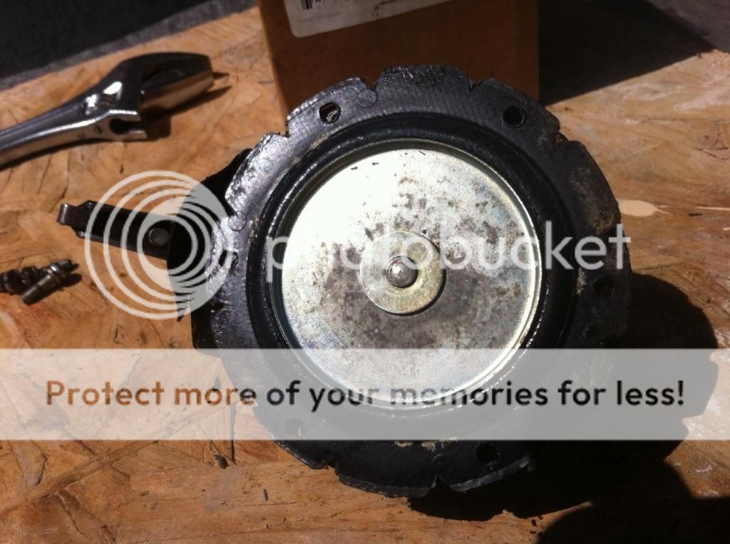

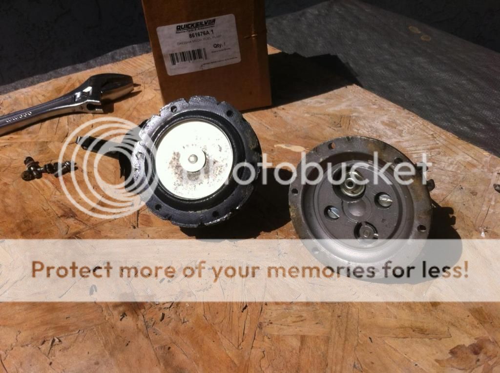

If your definitely getting a new pump... I'd be tearing my existing one apart. Check it out, if it is the diaphragm that's torn, Terry had a link to a diaphragm kit for one of the pumps that fit the 470, as an option....
And IF I was stuck with the new pump cause gas went thru it... and they don't take it back......
I think I'd break it apart and compare the two diaphragms side by side.... ;) maybe the good one may find a new home in the one that fits the engine ;)

I think that diaphragm kit was only for the older model pump. I will check again. Funny you mention comparing the diaphragms. I just came inside from removing the new pump and was thinking the same thing - wondering whether I could just put the new diaphragm in the old pump. I wouldn't care that I spent $200 on a diaphragm. I just want it to work.

It looks like the rubber is dry rotted and cracked around the metal part of the diaphragm to me. This is strange I replaced the pump on my 470 and had none of this problem with wrong pump ,etc. I guess I got lucky? Hope you get it straightened out soon .

Yep.... my failed diaphram looked identical to yours. Good ol' ethanol fuel!!!

You know, I can't believe that diaphragm is anything special. Bet they used them in many pumps, just need to match the size. Is there a number stamped on it?
Found this on breezeworks, I knew I read it somewhere. Try the spacer 27-43186 and check the pressure, if 3-6 should be OK. http://www.breezeworks.net/cgi-bin/M...urnPage=Search The one in the photo looks pretty thick, so if the new ones are thiner, I guess ou couls stack a couple. Good luck.

There are no numbers on the front. Do you know how to remove the diaphragm from the pump so I can check the back? I can't figure it out.

The new pump (8M0073435) seems to work great. Ran great on muffs for about 20 min with no flooding. Will try her on the water this weekend.
I noticed a couple differences on the new pump (8M0073435) compared to the 1st one (861676A1) I got.
1. I could move the arm down by hand if I pushed real hard. I could not get the arm on the 1st pump to budge.
2. The thick gasket I got with the new pump is made out of what appears to be wood instead of cork (like the 27-43186 I received with the 1st pump). When I tightened the 1st pump to 20 ft lbs, the cork gasket compressed quite a bit and was no longer the 3/16" it was originally. The new gasket did not compress at all.
Thanks for the help everyone!!
