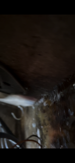

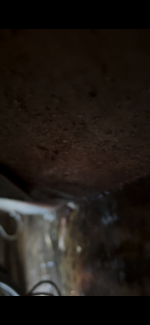

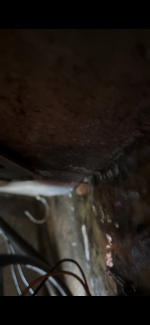

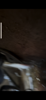

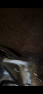

Had water coming in and replaced bellows and just took it out for first time after and still getting water in? Any other places water could be getting in? Seals or o rings etc....Posting a few pics and try posting video

rotten transom
since you mention OMC, the newest OMC is 23 years old and those were relabeled volvos, most OMC;s are much much older (coming up on 30 years old)
have you test drilled to see if your transom is wet/rotten?

I have not test drilled yet, I however did not replace the shift cable bellow. Was this supposed to be changed. I was told not necessary! Also do you know where it goes or location? Thanks again

Ayuh,..... Rotten transom,.....
I’m hoping not as boat is in excellent shape. Is there any way it’s a seal between it. ??? I’m guessing I need to remove outdrive again and test with water in bildge again to get better look where it’s coming from. Before removing the engine. ? Any suggestions would be much appreciated.

you must remove the outdrive before removing the engine
if your boat is over 20 years old, high probability of a rotten transom

Besides the water test, other signs of a rotted transom are gelcoat cracks around the outdrive cut out and flexing if you pull up and down on the outdrive hard (careful don't knock yourself out). A few people have had luck with seeing if they can get at the nuts that hold the inner and outer transom mounts together and tightening them. They can be VERY tough to get at, though. Might need a crow foot wrench or similar.
this is the problem with I/Os and why I will not have another. Lots and lots of places to leak water and none is an easy fix.
outboards only for me from now on.

I just went out and inspected bolts on inside of transom and they are a little loose. I can turn them a few times with my 5/8 wrench. I’m guessing these don’t just come loose. I was able to get to the top two and bottom two bolts. And does sound a bit hollow tapping on very bottom of transom inside boat. But only about 6 inches up. Is there something to re harden this taking motor out ? The outside of transom is very solid and no soft areas!!!! Thanks for the help and advice in advance

Ayuh,..... Boats rot from the bottom, Up,.....
No easy button to fix it,...... it needs serious help,......
52,739
the only easy button is a staples sales gimmick
drive comes off, motor comes out, transom shield comes off, you build a cradle, you remove the interior, you remove the cap, you then remove the floor, stringers and tansom.
you then go here. https://forums.iboats.com/threads/how-tos-and-other-great-information.283508/
read threads 14, 15, 18, 2, 3, 4a, and 4b in their entirety. look at every picture. watch every video.

You can try tightening the transom plate bolts if you can get to them but, even if the leak slows down or stops, your transom is most likely rotting and will continue to do so. Replacing a transom and most likely stringers too is a huge, pain in the ass job. I had the same situation one time. I lived with the leak and ran it for one season and then sold the boat to someone who fully understood that the transom was bad. Unless you just love that boat, I'd be looking at replacing it. Especially that it's an OMC. Nothing really wrong with OMC but a lot of parts are listed as NLA and, nobody will work on them. I'll never own a Sterndrive boat again. I thought that they would be the best of both worlds combined (inboard and outboard) but it turns out that they are the Worst thing out there in my opinion. Never again for me. :)
