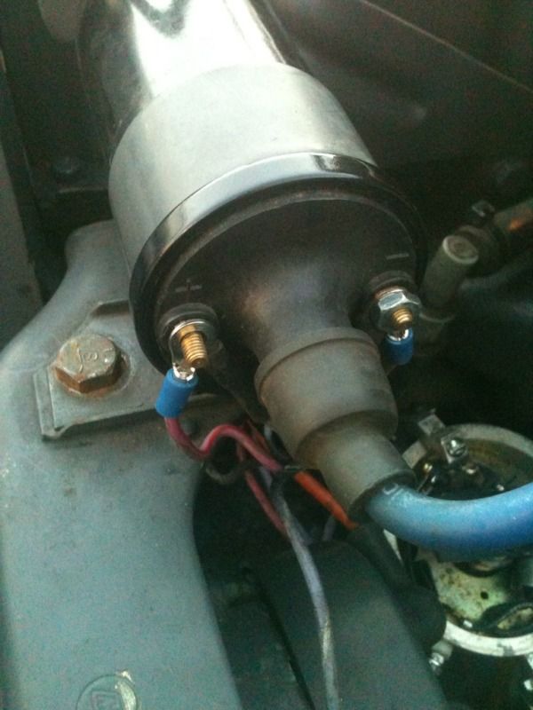

Ok I might be retarded. While waiting for the wife in Walmart I was sitting in the boat quietly sobbing to myself when I noticed the positive terminal on the ignition coil had no nut. Both wired were on it but not secured.
I had been cleaning and replacing wire ends and I guess I forgot the nut which is odd because I'm usually pretty meticulous about that.
So could those being on but loose be enough to cause my issues?
Levinz11
Apr 1, 2012
726
Re: Help please! Ford 2.3 and OMC Cobra outdrive stalls when shifted into gear.
Short answer...Yes. :D
Levinz11
Apr 1, 2012
726
With the engine running that connection would be vibrating....making contact with the terminal intermittently. Can't quit now man. You and that old girl have been through too much together.
