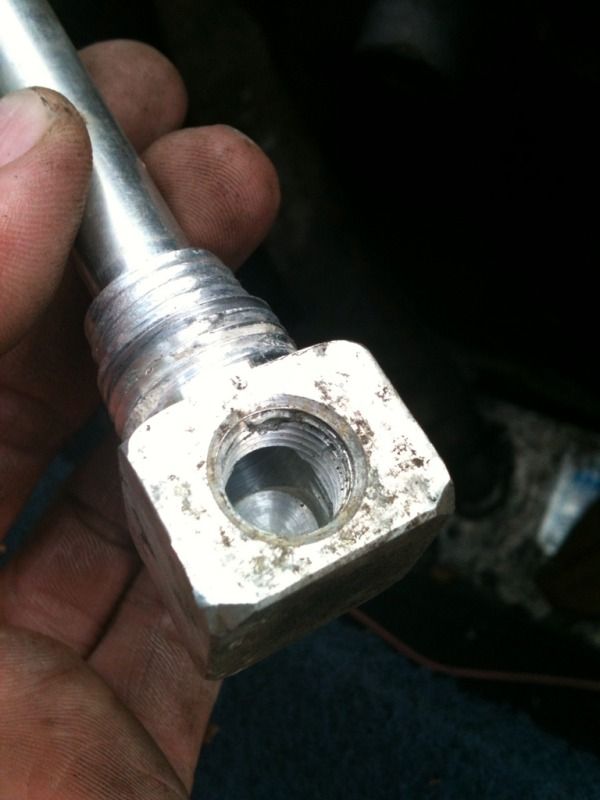

Today I pulled the whole fuel system. Aside from the lines being horribly corroded I found out that half of the tube going into my gas tank was clogged with leaves.
I cleaned these out and am hoping it is what was causing my engine to stall. Would that be enough?

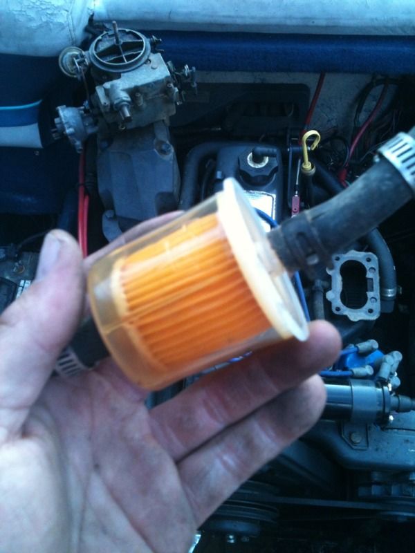

Two questions; this appears to be the only thing I have for a fuel filter.
I'm pretty sure that having a plastic fuel filter on a boat is bad, right? I plan on replacing it with a generic steel one. Is this ok?
Second, I have read that there is supposed to be an anti-siphon device at the tank. I have no such thing. It goes from hard elbow in the tank-fuel line-fuel filter-fuel line-fuel pump. Am I missing something?

You don't want that fuel filter. Buy a marine water seperating filter which will be in the line between the tank and the fuel pump.
You need an anti siphon valve as well.

Gotcha, I will start looking today. I still can't figure out how leaves got into the gas tank, unless the cap was left open for a long time or kids shoved leaves in it or something. Before I opened it there were no leaks.

You may opt for a right angle one depending on your tank.

I think this one will do, my pick up tube already has a 90 degree fitting so this should screw right in.

First I drained the tank which took forever alternating between 2 one gallon gas cans. That was fun.
In order to re-drill the stripped pick-up tube hole I has to pull the water pump, it was in the way.
Getting the tap straight took forever, but I finally ended up with a straight solid set of threads.
Lastly I cleaned the tank. I used a shop vac through the fuel gage sending unit hole while simultaneously spraying water in the hole I just tapped. I pretty much did this over and over with the front of the boat elevated until no more crap floated back, and there was a lot.
