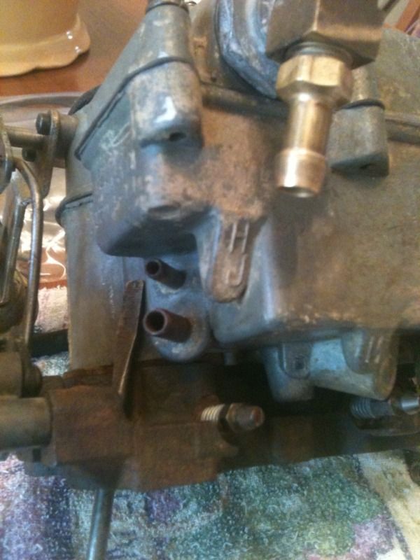

Ok, quick update and 2 questions.
I didn't get the boat in the water yesterday. I was messing around with the carb and noticed one of the gaskets was leaking. Upon reassembly I had stripped out a screw holding it together, but I used loctite and thought I got it tight enough. I guess not. So I ended up tapping the hole out to 1/4 SAE and getting a new screw. Time consuming but worth it. Didn't matter anyway because my friend couldn't make it, and he is bringing his jet skiis in case I need hauled back in!
Idle is still high I think. My tachometer in the dash jumps all over the place, so I am really not sure what I am at. Haven't had chance to check the wiring yet. On a 2.3 would 7G be a pretty brisk idle? I don't want to damage my gears.
AND MY QUESTIONS;
1)Does anyone know the SPECIFIC carb part number I need to order with for a MARINE carburetor, and maybe a cheap place to look? Lowest I have found is in the $300 range. I won't be avle to get a core deposit because I don't have a marine carb to give back.
2) Do I need an electric or manual/temperature choke? This probably sounds dumb, but I want to be sure. My carb now has a terminal off of the choke housing assembly and a wire going to it, but it also has a "choke vacuum diaphram assembly" with only a vacuum line going to the carb. On most places when ordering I have the option to choose.
Thanks guys.

I am also having NO idea where these vacuum ports would normally go on a car. I plugged them to be safe, but now I have a hard time keeping an idle.

Re: Help please! Ford 2.3 and OMC Cobra outdrive stalls when shifted into gear.

You need a dwell/tach/timing light combo or all three seperately if you want to keep working on your boat.
The carb on my boat is a Rochester R2-2GE. According this your boat originally came with the same carb...http://bpi.ebasicpower.com/c/OMC6C-IB/Carburetor+Kits+for+OMC+Inboards look about half way down the page.
Looks like $300 is the going rate for that carb.
Can't help you with the choke question. Do you have this manual ?...http://www.mediafire.com/?j74z0nib459gh

Ok quick update;
After rebuilding the automotive carb as best I could with a marine rebuild kit and re-tapping a stripped screw hole I put it back on the boat.
In an effort to get my tach working I checked the wiring under the dash, the fuse, and the terminal off of the distributor (I believe this is where it gets it's signal right)? That terminal was heavily corroded do I cleaned it and dabbed grease on it after putting it back together.
The tach now works intermittently, but only for 1-2 seconds.
So yesterday I put it back on the water. No matter what we did to the carb, adjusting both the idle screw and the adjustment screws, we could not get the engine to idle below 12-1300 rpm. Anything less as the motor just dies.
I assume this is why my boat stalls in gear. My buddy noted that at an idle the carb was pretty much just trickling fuel into the intake.
So I have decided I'm done working on the boat until I get a new marine carb. I'm thinking this is my problem, and even if it isn't I want the right carb on the boat anyway.

The signal for the tach comes off the coil. Sometimes this trick will get a finicky tach to work again... Find the screw on the back that selects 4,6,8 cylinder engine. Turn it back and forth like 20 times and leave it in the appropriate position for your motor. 50/50 it will fix it.
Have you tried unplugging those vacuum connections?
Ya, I tried with those ports both plugged and opened. I'll try the coil adjustment thing Sunday, we're camping at the lake right now. Seems like everyone has a boat except us lol. A least we have a camper!
