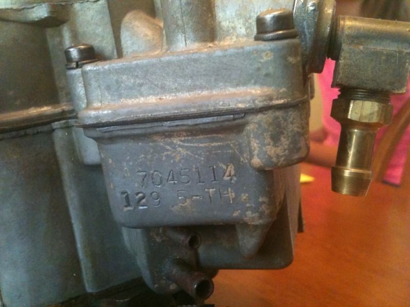

Re: Help please! Ford 2.3 and OMC Cobra outdrive stalls when shifted into gear.
Ok, it's 7045114. Auto? Marine?
Here are some pics of mine. A Google search of your part # returned carbs for Impalas, Monte Carlos, etc...
Thanks for the pics Levinz!
I guess that's my answer to why that rebuild kit didn't fit right, I'm pretty sure mine is an automotive carb...
At least I know now.
Yea, it definitely is.
