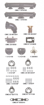

No Its an open system. I am running off the muffs (Fake Lake) I just installed a new impellor and cup. Finished the motor today ran very nicely. Just worried about manifold temps. My sender unit is broken and the boat has an idiot light not a gage. That is why I need info about the hoses and exhaust to riser gasket cut off. I would think the return water should exit the manifold into the riser but the gasket does not allow it to flow out. I though of maybe cutting away the missing hole for the port but want to be sure if the water is not supposed to exit the manifold before I do and get water into the engine as a result. I Also needed to know if the water intake from the impellor water pump goes to the bottom or top of the T stat housing T. The inlet comes from the lower port of the heat exchange with free flow the return is cut off and does not exit the exhaust manifold. By the way This engine is a Dauntless V6 Odd fire engine and i have the parts list for the entire exhaust below.

If you lay the two pictures below on top of each other it may be more clear on what I am trying to describe. There should be a hole but it is blocked off at the rear riser gasket and open at the heat exchanger. The blocked port gasket wont let water exit the Exhaust manifold. Is that correct or should it be open with an open system? The right gasket there should be flipped opposite but still the same result. (Mistake editing it). The third port in the exhaust manifold is covered by the heat exchanger it has no purpose I know of.

WOW Ok I think I got it. The camel hump threw me off. The gasket is like a valve one way for a closed system and rotate it for an open system. I am just going to rotate the heat exchanger to the proper position. Last owner had it set wrong. Still need to know if the cold raw water inlet hose goes to the upper or lower of the Thermostat T and I should be good to go.
