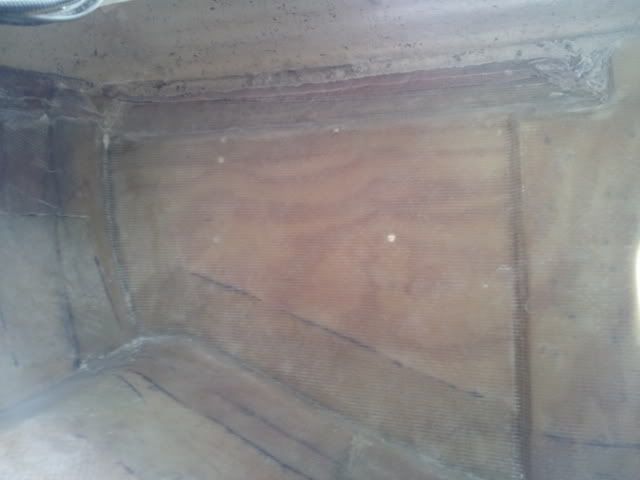

It went better than the first layer, but still not perfect. I'm just gonna continue with my stringers and come back to the transom in a few days when it has a little cure in it and grind it up nice and purdy and remove/ patch a few bubbles. I can get smaller pieces to lay down nicely. I might try doing a transom skin in sections if I ever do it again.

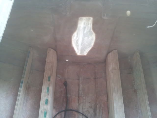

It isn't bad by any means. But its not great. I'm gonna grind and clean it up some and fix em up. If it doesn't measure too thick now I may do a little grinding on it and try to apply one more layer, in three sections so I don't have so many contours working against one another.
Crappy picture, but its all I have to show at the moment.

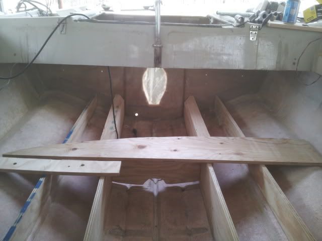

Re: dixie hustler "deck job" (turned full rebuild)

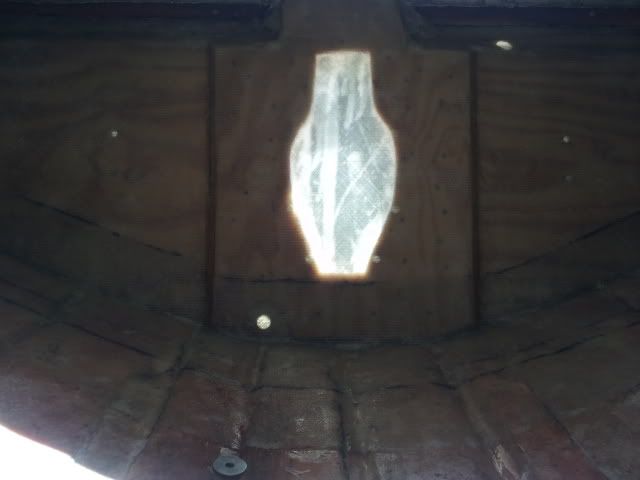

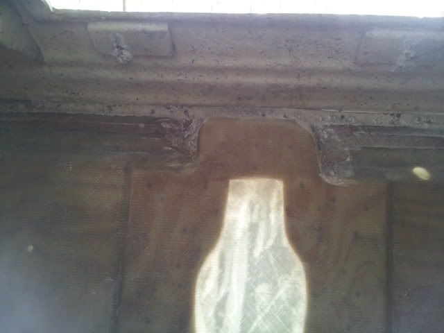

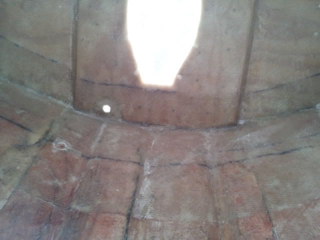

Couple more shots of the transom. I ground a few spots on it today and worked on my stringers some.

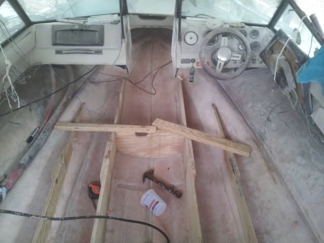

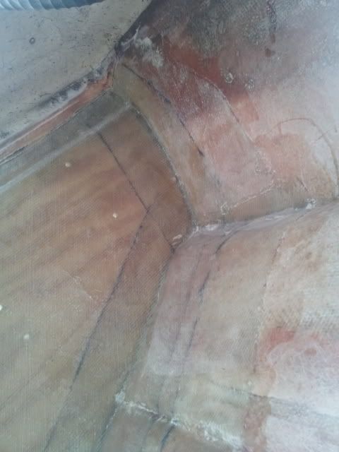

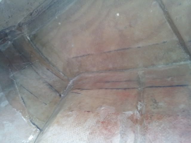

Stringers in place and 'glued' down.
I'm gonna attack the stringers in sections. One 'box' at a time. Fillet, tab, layers one and two all at once. Cutting it into these bite size chunks should help it keep from seeming to be overwhelming. I also still have to extend the bulkheads the rest of the way across the boat. I did something wrong when cutting the bulkheads that are there. They are a good inch off the hull. So I guess I'm just gonna have extra pb there.
Good strategy, focus just on the next thing you need to accomplish. Occasionally, allow yourself to think about what all needs to be done, but just to make sure you're not forgetting anything.
Looks like really nice work! Can't wait to see how this boat comes together.
Lookin' pretty good!
I'd have made those joint splices a lot longer, but by the time you get everything filled with foam they should be ok.
Lookin' forward to seeing some of your glass layups.
I will keep that in mind for next time! I am already eyeing a small tri-hull sitting on some tires I noticed a month or so ago ;).
I plan to tab these joints before tabbing the stringers to the hull. Will that help? And how much of an overlap for the tab?
I grabbed the keel stringer by accident when I was looking for a scrap of wood to tack the outer stringers to to hold it upright for bedding, and used it to tack to the tops of the stringers :embarassed:. So once the bedding sets up for a couple days I'll untack the keel stringer and put it into place. I haven't even dry fit it yet, so I don't know what to expect from it yet. I used pl for my bedding. I won't be able to touch it again until at least Mon., maybe Tues., and it's been 80 degrees for a week or so now, so it should be dried well.
I have a few spots where the stringer-hull gap is half an inch or so, so I'll bed those spots with pb since it's so thick.

The glassing looks good ! Seems your getting the hang of it very well .. :high5:
Good to hear, because I wasn't pleased haha. The very top above the keyhole was awful, but I cleaned that up today with a dremel and a grinder. That was just so many contours so close together. I haven't checked the thickness or flatness around the keyhole yet.
