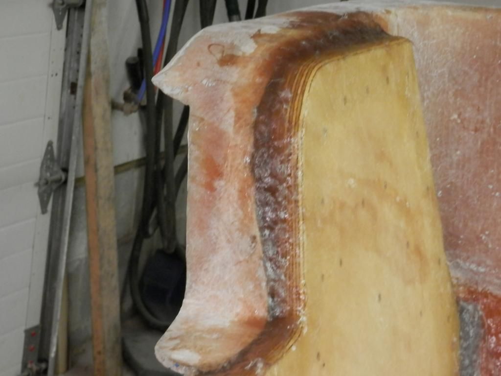

I'd be more concerned about ripping your fingernails off 'trying' to pull the transom loose. 'Cause I suspect it's not just gonna be stuck, it's going to be WELL STUCK........... I seem to have missed the hollow areas too.......
Gibbles
Nov 14, 2009
2,046
Re: Deck coating / Turned complete restore
I have to wonder what the manfs idea was with those hollow areas...

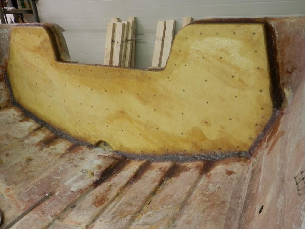

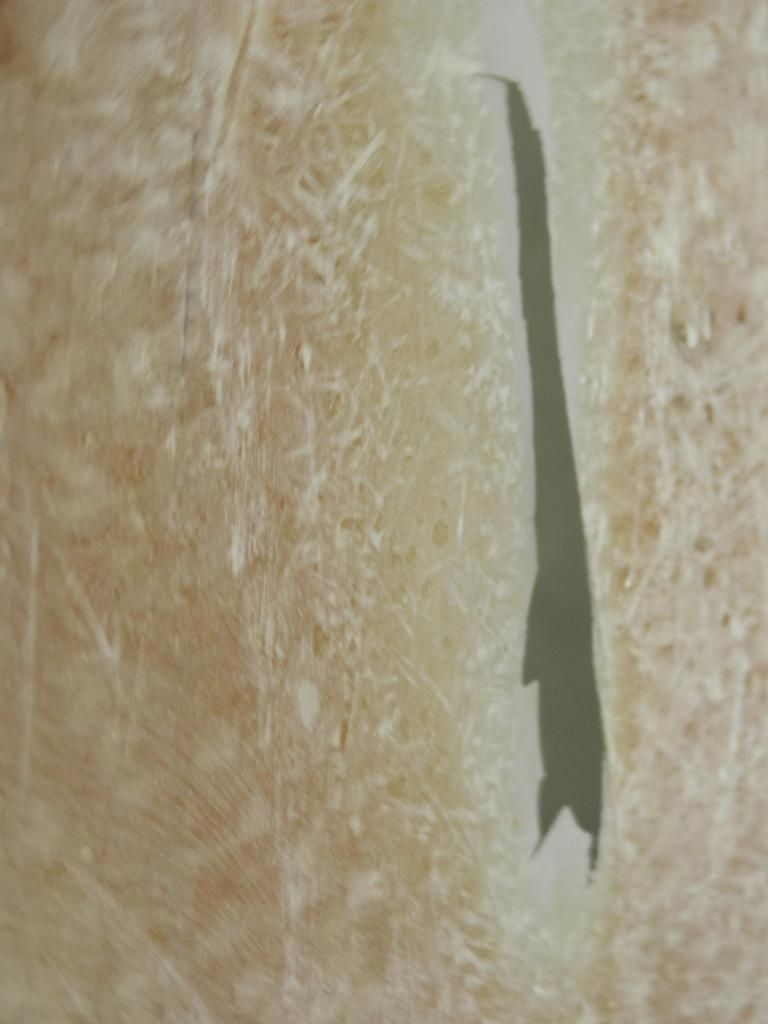

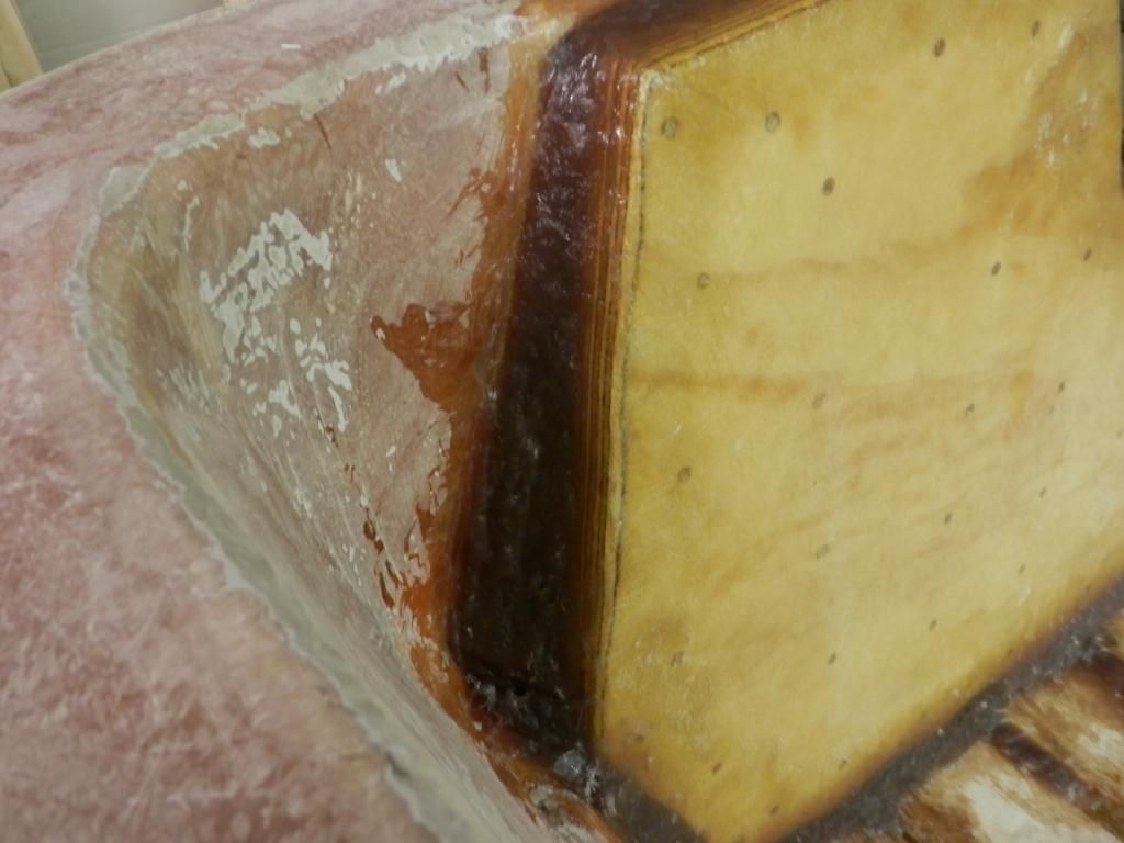

Thanks jb gibbles and gt Pulled clamps off and it was stuck on really well so i fillet it in

pb before catalysis and filler and after
ahmincha
Jul 21, 2012
1,512

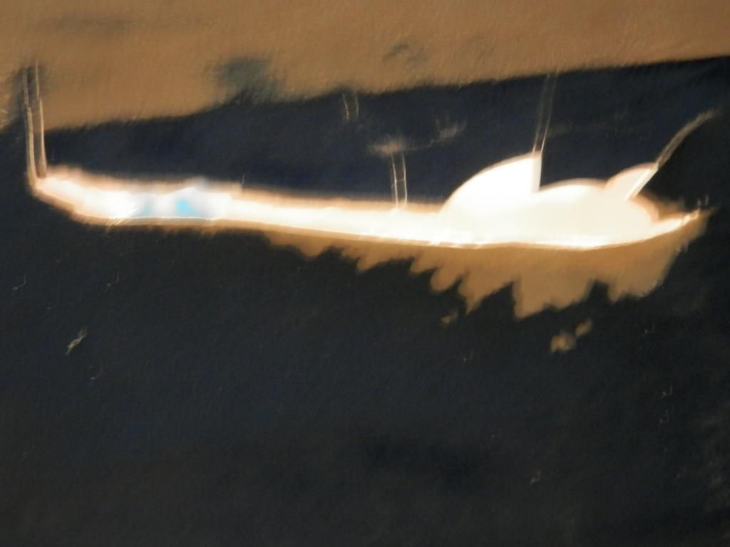

Wood gave me instructions on how to repair my mess ups. This one is about 3" long and 1/2" wide at its widest place wouls the fill with pb then 2 layers of 1708 on wax paper work for this mess up also or is it to big second one is outside its about 2" above chine
Woodonglass
Dec 29, 2009
25,932

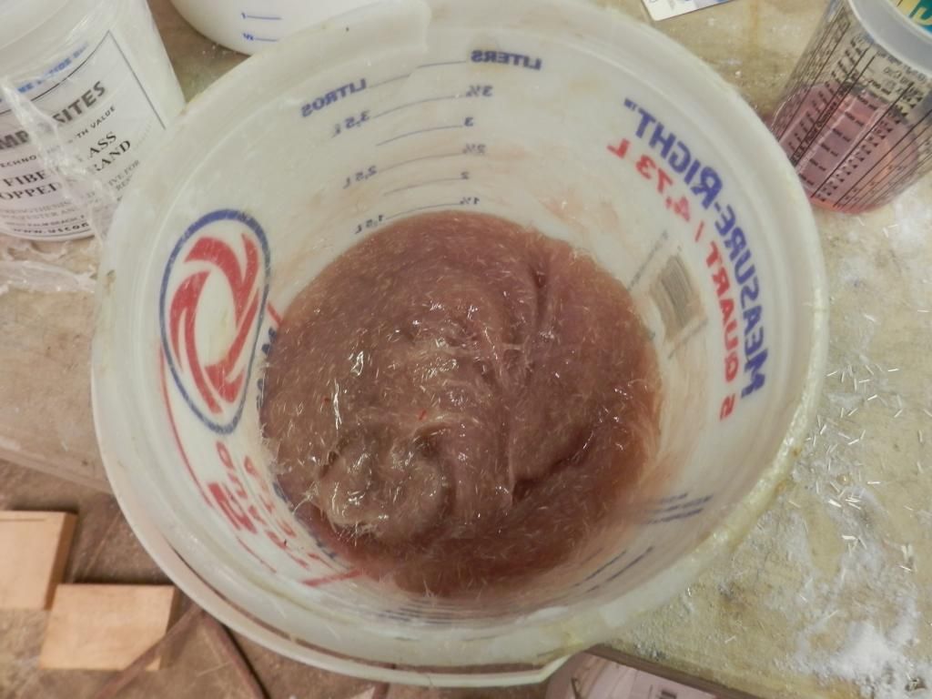

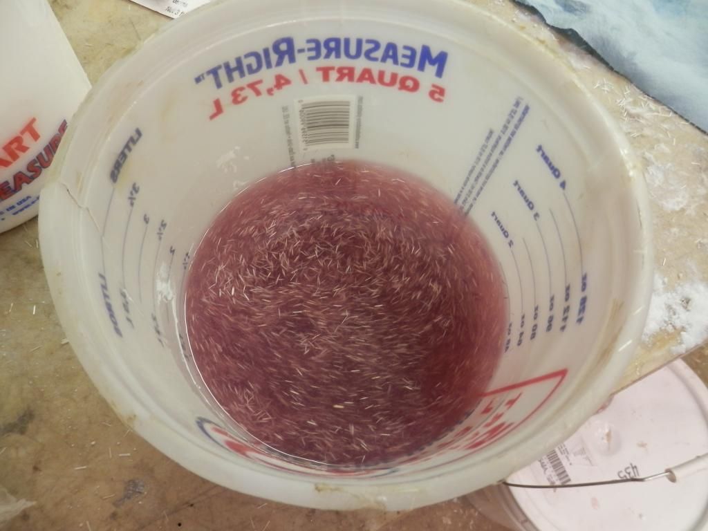

Hmmm, Looks like the transom survived your tuggin and pullin!!!:D Fillets look fine. I'd say you're a bit heavy on the Fibers. Hou much you puttin in. I'd recommend about 1/4 cup per Quart. The wax paper patches will work fine on what I'm seein'. If you can carry it to the hull without makin a mess it'll work.
ahmincha
Jul 21, 2012
1,512
Umm I just guesstimated the fibers probably closer to 1/2 cup I will cut back on that. Yes I was able to get my hands behind the transom and pull hard enough to move the boat and me I also put some pressure on with a prybar

ahmincha
Jul 21, 2012
1,512
I used less fiber this time made a world of difference Thanks wood

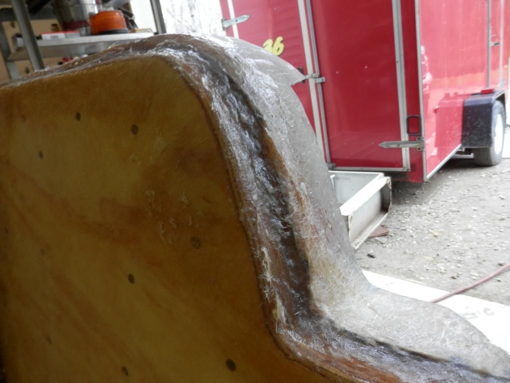

These are pictures of the top of my transom where it meets the hull I guess. My plan is to pb even with the existing fiberglass then lay new mat over the whole lip . I hope that makes sense Also what should I use 1708 csm or 18oz woven
Woodonglass
Dec 29, 2009
25,932
Personally, It's not structural soooo, I'd put a couple of layers of CSM and call it good. You're just looking for waterproofing and the CSM will provide plenty of that along with the resin. PB looks mucho bettero!!!

Ok one more question I didn't see it mentioned in woods deck stringer and transom instructions when I tab in the transom with the 1708 what size width on the strips would first tab of 6" and second with 8" work also I am going to touch up my pb do I have to wait for it to harden before I tab

One 8" tabbing should be adequate. Then a Full layer of 1708 that extends 4"past the tabbing. Finish up with a Final full layer of 1708 that goes 4" past the previous one. Once the PB is somewhat solid you can start tabbing.
