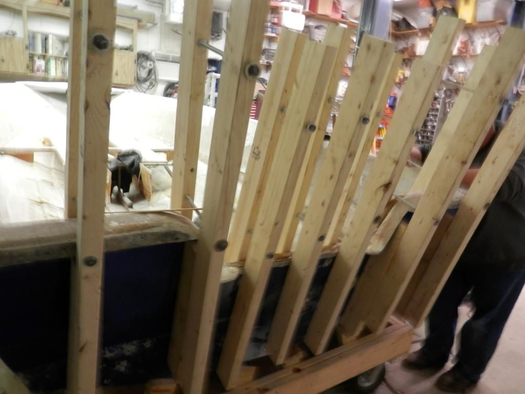

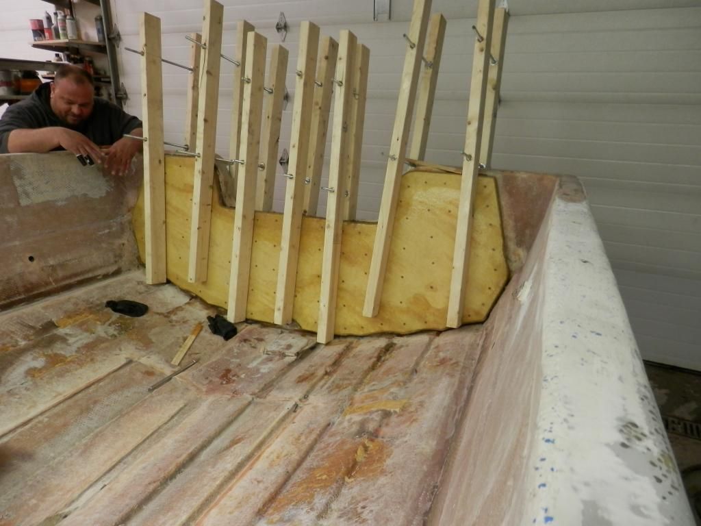

Thanks friderday ahat and wood I ended up doing 1.5% put in transom. Is it ok that a little resin is dripping out
Woodonglass
Dec 29, 2009
25,932
Re: Deck coating / Turned complete restore
Very Nice clamp up! Only thing is...Not seeing much PB oozing out around the edges. Did you put a LOT on??? You should have enuf to be doing some filleting I'd think!!:confused: How many quarts did you use? Did you drill any additional holes to allow PB to ooze thru the transom?
ahmincha
Jul 21, 2012
1,512
Darn it I forgot the holes I used 4 qt of pb I thought i would have it oozing out also. I spread it on a good 1/4" on transom and skin probably heavier in most spots
Woodonglass
Dec 29, 2009
25,932
How much clamping pressure did you apply?
ahmincha
Jul 21, 2012
1,512
I think I put enough I made sure the skin basically was tight to the wood. some squished out of the transom holes and across the top where the motor sits
Woodonglass
Dec 29, 2009
25,932
Well 1/2" should be plenty. If you go out tomorrow and she's solid as a rock then Badda Bing!!! Ya dun Rite GOOD!!! Mix up some more PB grab a spoon and some MS and let the filleting begin!!!:laugh:

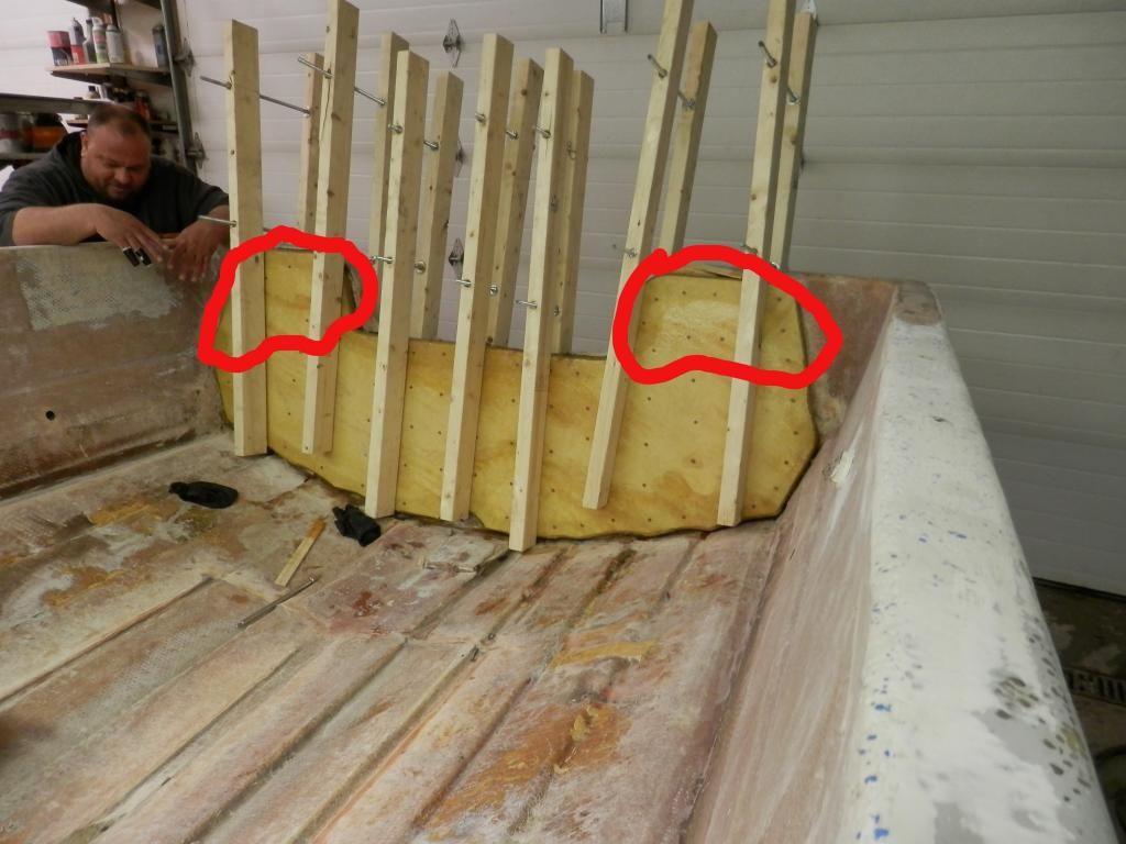

Area within the red circle is h0llow behind transom

Hollow??? Is that on purpose or...OH CARP!!!!!! Yes MS is Mineral Spirits!!!
ahmincha
Jul 21, 2012
1,512
On purpose thats how boat was designed those 2 bump out on the exterior of the transom are hollow and were full of water when I removed wood

OK!!!! I remember Now. Does it seem to be setting up ok??
ahmincha
Jul 21, 2012
1,512
Yes what did make its way out is hard as a rock I did not take clamps off will do that in the morning. I did notice there is some resin that came out in a few places bottom of hull and on the floor I would guess that's normal. I think I made it to hairy to quote frisco it was a little tough to spread. Kind of wanted to peel away instead of stick but I got it everywhere. Clamped it up around 2pm today can I remove clamps in the am
