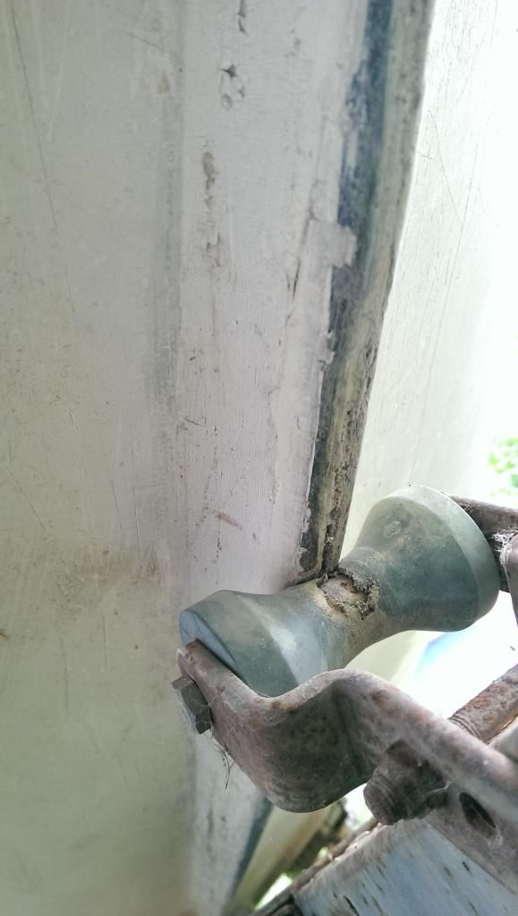

This is right on the ridge under the boat. Keel I think it is?

The damage to the keel seems to have been caused by the worn out keel roller.
Not a huge deal compared the the rest of the work that lies ahead...
