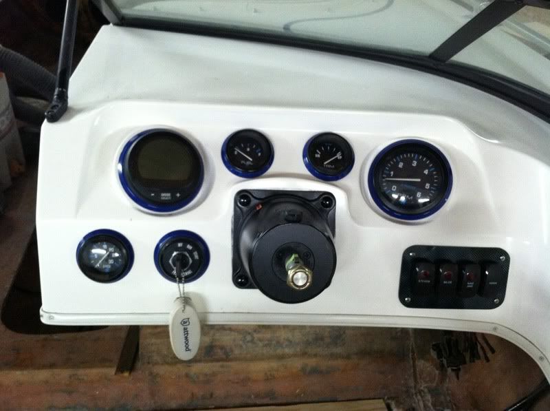

Got some more pictures from some work thats been done.

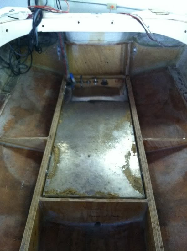

Fuel tank installed.
New helm & switch panel

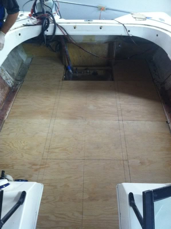

Floor!:banana:

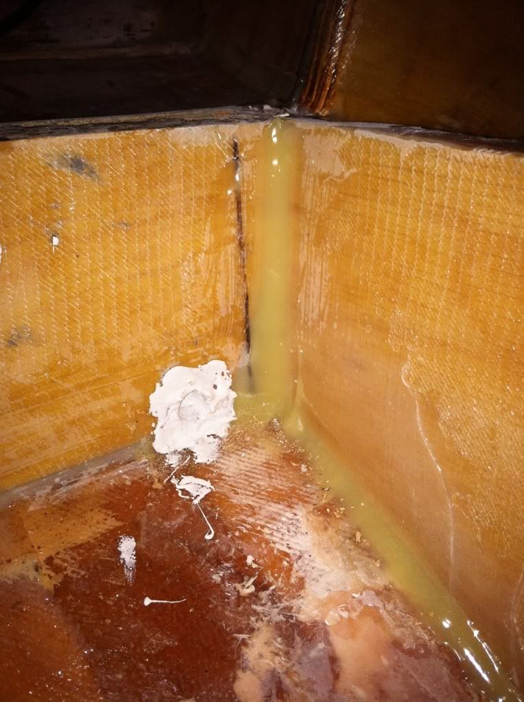

I would not want to do a project like this again honestly. Lots of work & the boat is not even that big LOL. I understand Checkmate has cut costs to make the boat affordable but cutting corners is another thing. Most of the rot could have been eliminated very easy. Lack of drain holes for stringers creating wet foam with a floor that is not glassed on the underside is asking for trouble. Sad thing is I have seen some of there new boat builds & they look not better. Anyway few more pics.

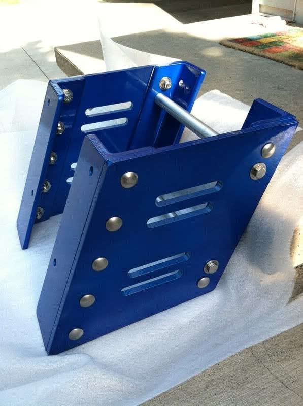

Setback bracket

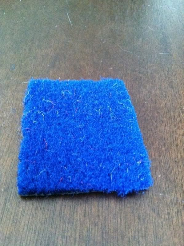

Color of carpet thats going in

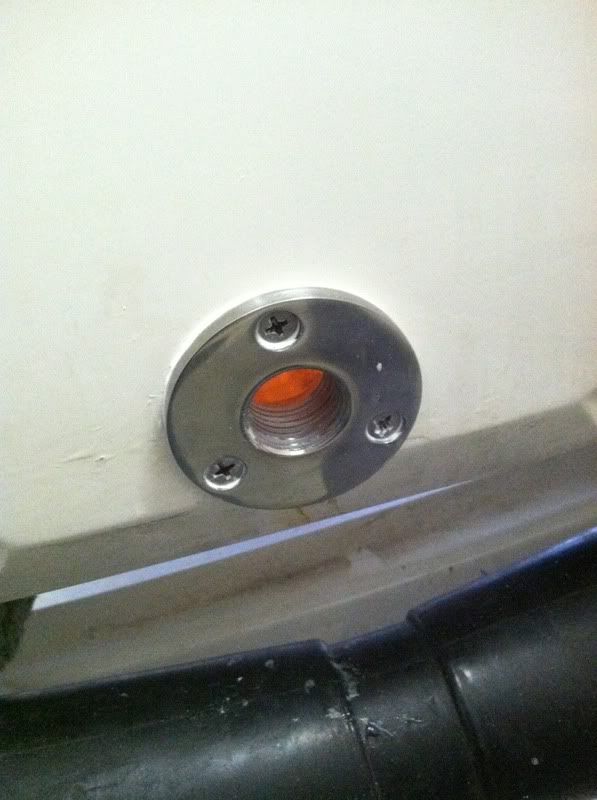

Drain set up, on inside is a 5200 sealed brass tube
One of the stringer's drain holes

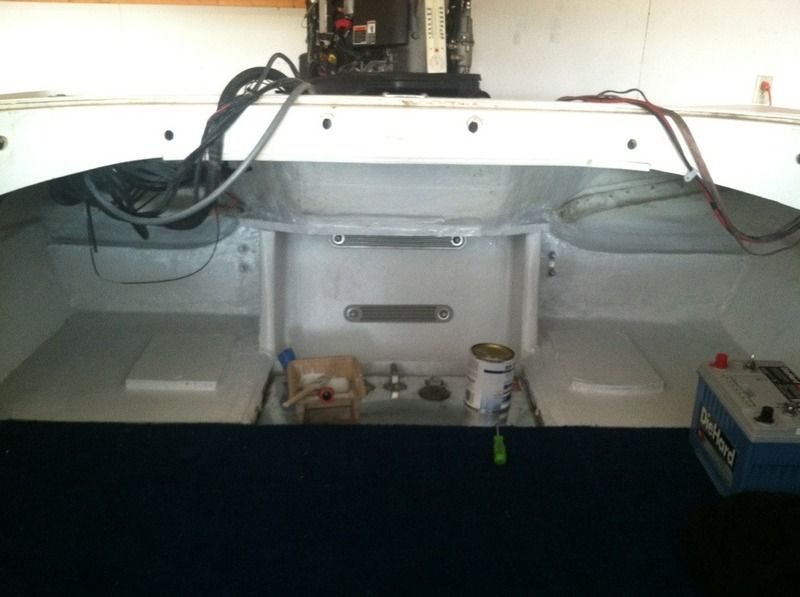

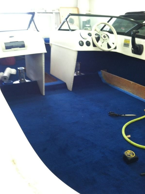

Wrapping up interior & run motor on muffs today. Might head to lake for a test run tonight.
Bilge area painted.

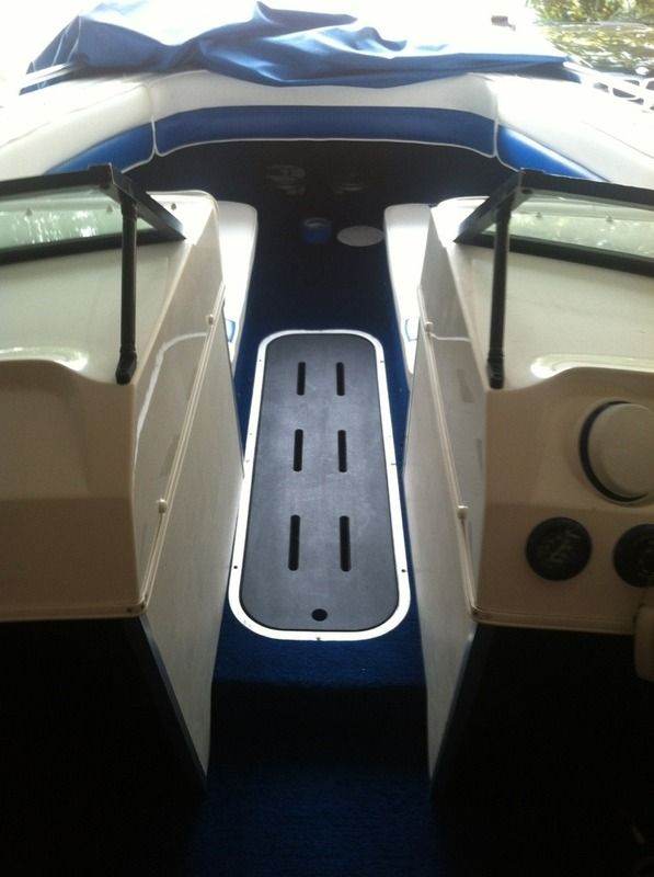

Carpet being installed. Glad went with blue.
Front interior close to finished

Re: 95 Checkmate Pulsare 2100 Resto
EKmate, how do you like that setback bracket? How much total setback are you running?
