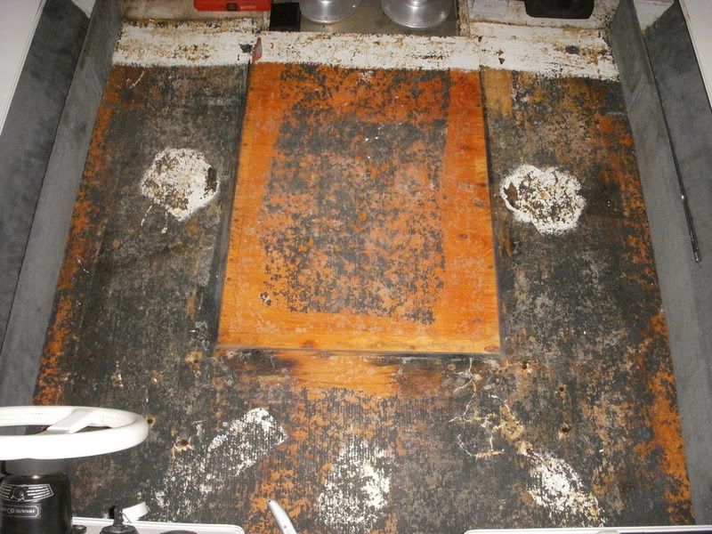

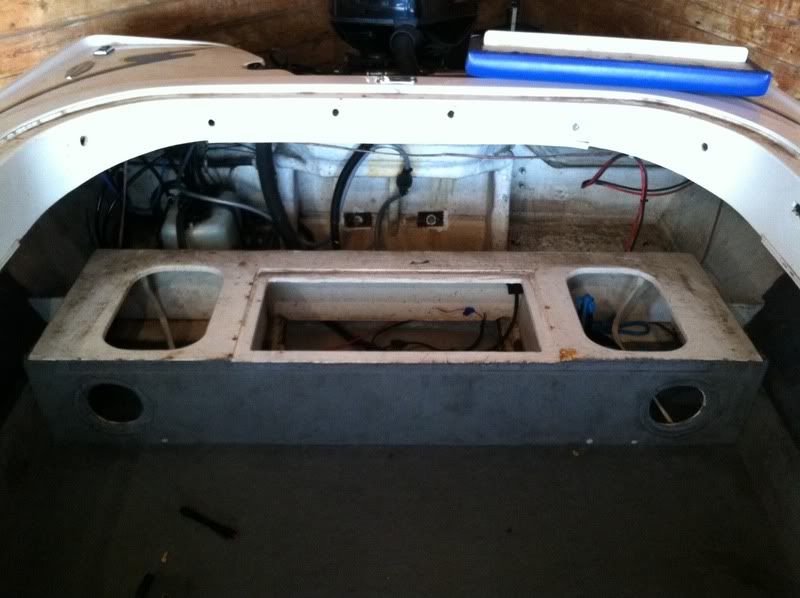

Removing rear seat. Seat box is ok.
Passenger seat that started to come loose.
Carpet off floor
Center foam weighed about 40lbs

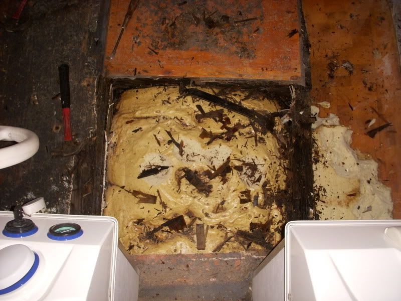

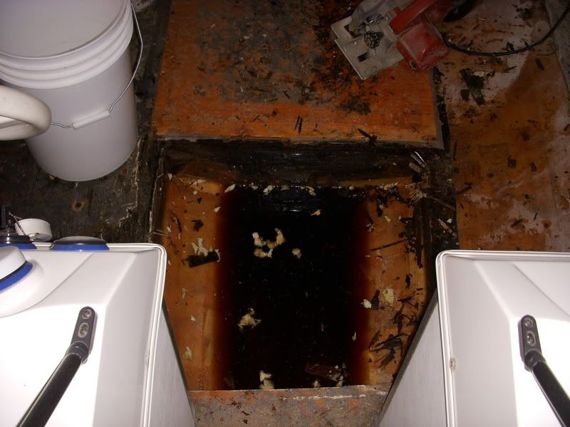

What was under foam

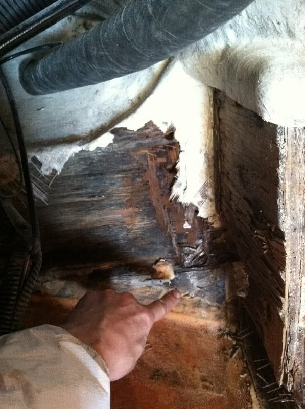

Stringers are all rotten & only partially glassed

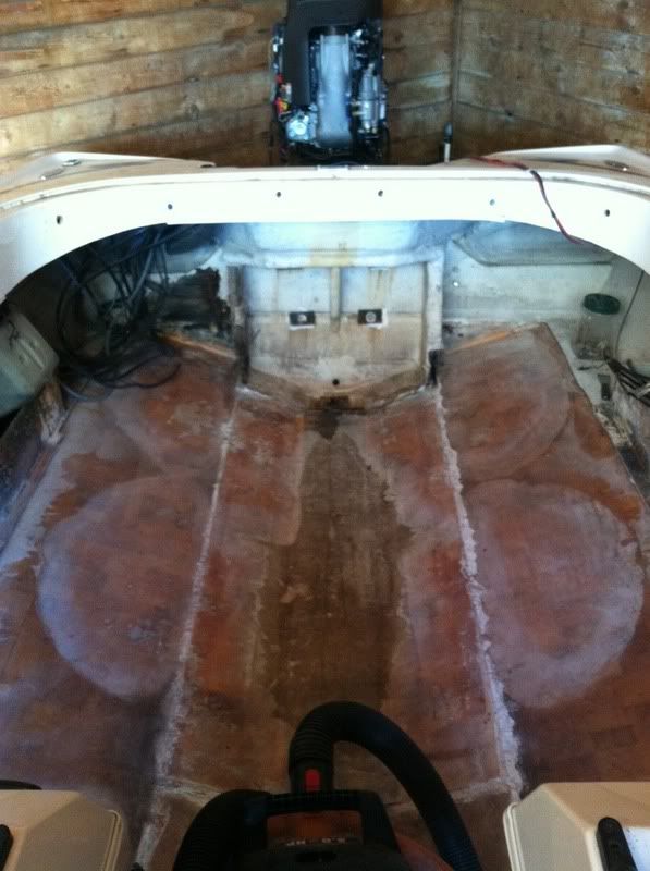

Most of floor & stringers out

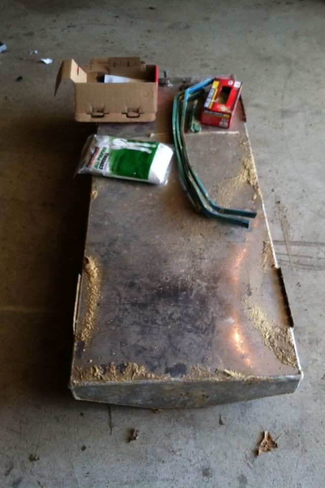

Tank out & will clean up nice

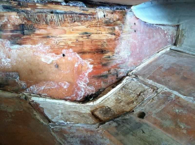

Transom out
Pic of work area

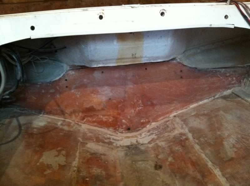

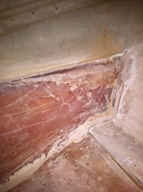

Area of concern from a hole made by screw. Will drill small hole at end of cracks & fill with epoxy I think
Near the end of transom the hull has large voids near top. May fill before installing new transom.

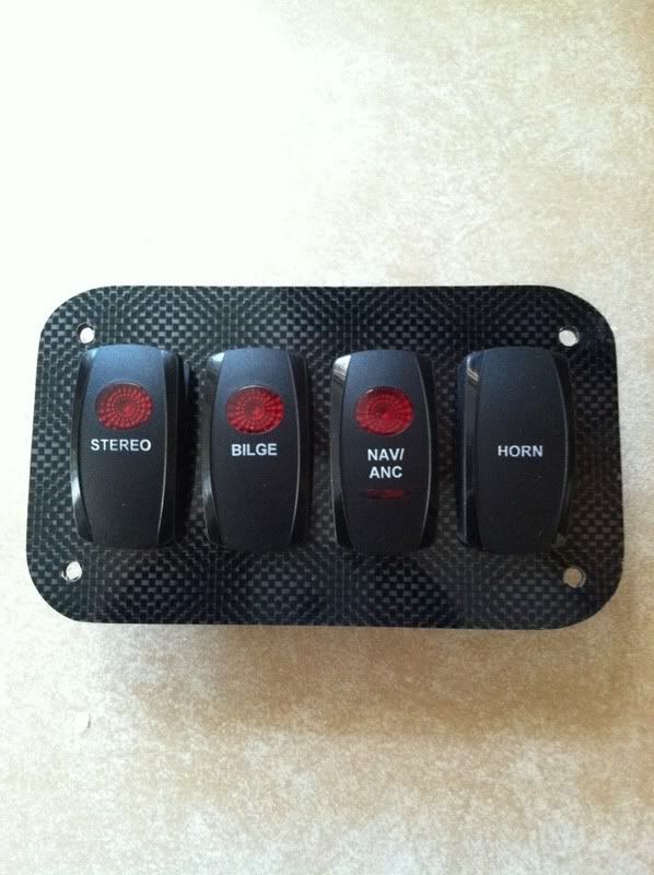

New rocker switches

BTW - Check the fuel tank for corrosion and pitted surfaces . . . it looks like to was exposed to moisture from the structural rot.

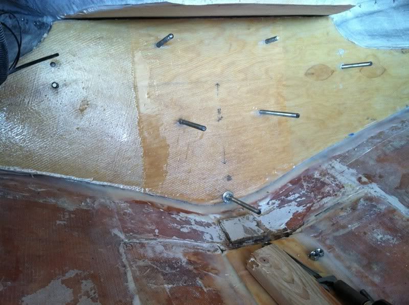

Long over due update & progress has been very slow due to all sorts of things. Anyway had chance to glue in the transom. Problem is now my threaded rod used to clamp is bonded in also. Any hints on how get them to pull out. I am afraid will crack/damage something if hit them with BFH.

Lock two nuts together and use an impact wrench to turn them out maybe ?
Yes thats my plan tonight. Going to cut them shorter, lock two nuts & heat them up. Hopefully will turn out with my impact or big breaker bar.

I am using epoxy. Easy to use & no smell. So wish used long bolts or should have removed the threads were it passes through transom. Oh well guess gotta learn somehow.

Got the threaded rod out with no issues. Used some heat from Map gas torch on rods for about a minute & was able to turn/pull them free. Filled in any gaps on transom & built the knee support that bonds to underside of splash well. If all goes well should have stringers glassed in by end of weekend.

Knee support is in & finished up with the fillet work on the transom. Will add some fiberglass tomorrow to tie it all in. Started to fit the stringers but got really hot out & decided to call it a day. By the end of the weekend I hope to have the stringers set. Will feel great to have the transom area finished as that seemed to take forever.

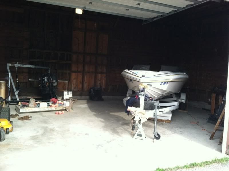

Moved boat into the second shop also. Its heated, better lighting, air compressor & still plenty of space.
Transom ends are ready to get glassed in to tie it all to hull & knee support bonded in.

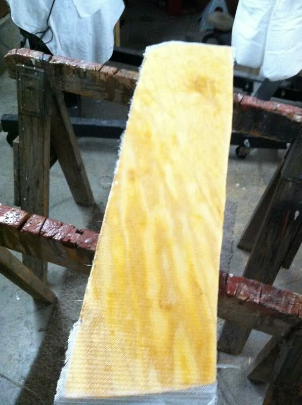

Next was to make replacement piece & glass.
Finishing up transom work.

So one question I have is instead of using my 2X8's for stringers I like the idea of bonding 2 pieces of 3/4 marine ply for them. They would be 1 1/4 thick with thickened epoxy in the middle. Seems like better idea & less weight. Thoughts?
