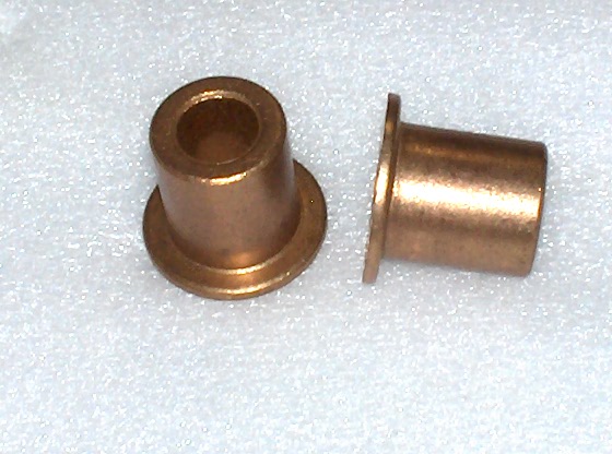

There may be some small brass fittings that could be adapted to work as your console shelf drains, flanged brass bushings come to mind:
They come in a lot of lengths, widths & flange sizes. Slightly counter-sunk canted & angled into the back left or right bottom corner (both) to bury the flange & make the inner hole about flush w/ the shelf.... and if you need it to be longer to reach all the way thru the 3/4" ply you could braze a short length of pipe to be back & then attach a hose w/ clamps to further direct the water......
Thanks Jbcurt! I can't tell you how many different places I've looked to see if there was a brass thru-hull fitting that was of a smaller diameter to try and find a nice-looking way to drain that shelf! Those bushings are a great idea!

Yeah, I've been trying to find a way to drain that shelf that looks good and that I won't lose stuff in - most of the drains I looked at are too big, I don't want to have exposed plywood - a fitting is the ideal situation, but until now I hadn't seen anything small enough! This looks like it would be perfect! I should be able to use those in the bottom of the tackle storage too, which will be really nice...
