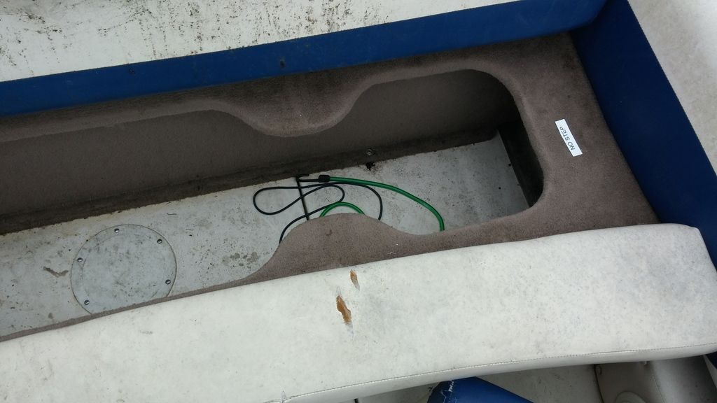

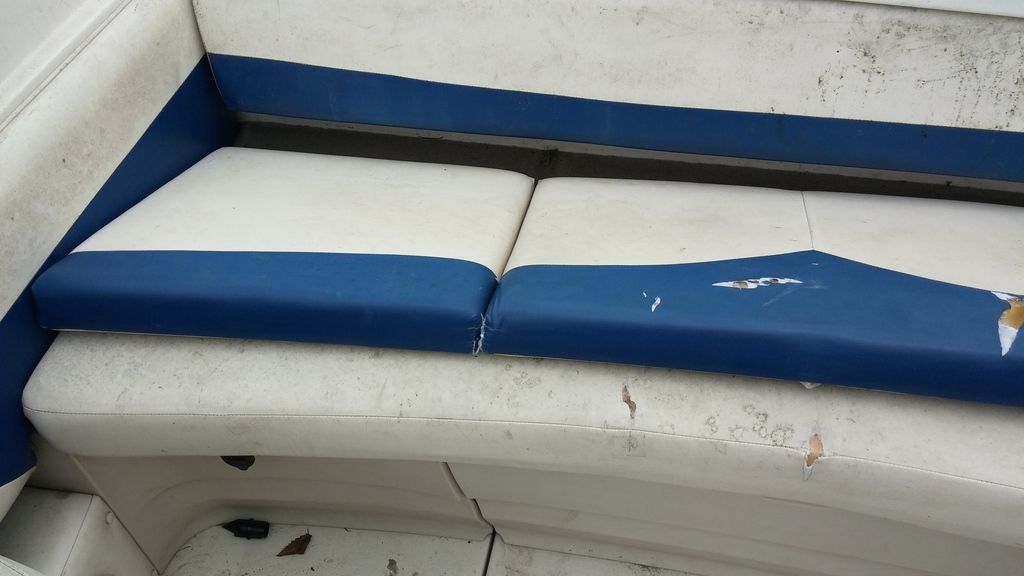

You mentioned that you removed the rear seat. I am trying to figure out how to remove the bolster part to recover it. The long part right in front of the cushions. Can't find any screws hidden under carpeting. Mine has 3 seperate cushions.

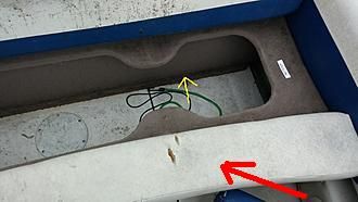

Feel along the edge of the carpet where I made the arrow, Should be around 8-10 holding 1.5" screws holding it to the floor. Our seat is a little different. Is this your 2002? Also that petition with the fire retardant insulation has 90 degree aluminum brackets on each side.

Yes, it is my 2002. I have more info on it here.
http://forums.iboats.com/forum/other/dockside-chat/10189872-dragged-home-a-new-to-me-boat
This is the part I am trying to get off. Not sure if yours is the same or not.
