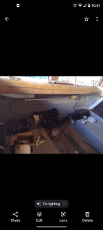

Lot of sealing today. I got the cap back on and sealed some thru hulls.
I was so mad. 3M 5200-4200 literally says it won't web or droop...Wrong! I got it everywhere! But, I learned a secret after trying just about everything, including the 3m remover they recommended, to clean it up. I'll probably have someone chime in and say it's bad because of this or that, but I blasted it all off with brake cleaner. Didn't even have to scrub. Just wiped it up when I was done.
