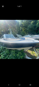

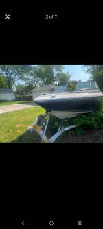

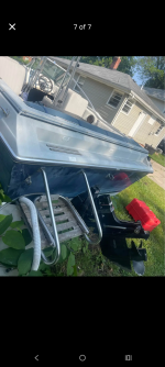

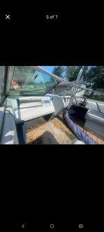

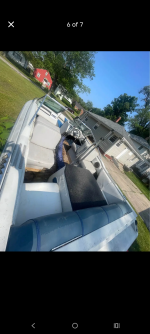

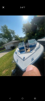

This is where my journey starts.

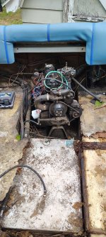

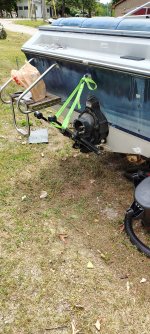

I've already taken out the seats and motor cover. I took out the starter to see if it's functioning. It sounds like it's not meshing well with the flywheel. When I went to take it off I noticed one of the bolts were loose, so I'm thinking that was part of the issue. Still going to get it tested before securing it all the way down.

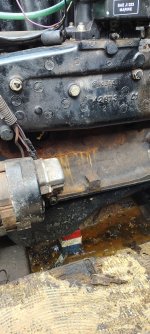

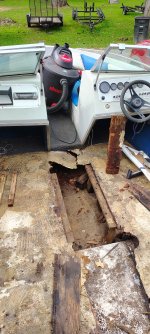

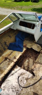

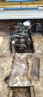

Okay... So after further inspection and fighting a bunch of wasps, there is A LOT to do to this thing. The stringers from the areas that I can see so far are shot. Just mush and mulch. Haven't really looked at the transom yet but I'm assuming the worst. And while putting the starter back in after getting it started I saw a crack in the engine block. Uh oh... So the doom settled over me.. I'm a bit nervous now. But I want to do this so bad. So I will be taking all the floor out to see the full extent.

You would be correct. I got part of the floor off and the stringers are completely shot. No I'm pretty sure that's a crack. I'm going to get it diagnosed just to be sure before I tear into it and see if it's worth it. I took the motor apart and removed the anchor bolts.
