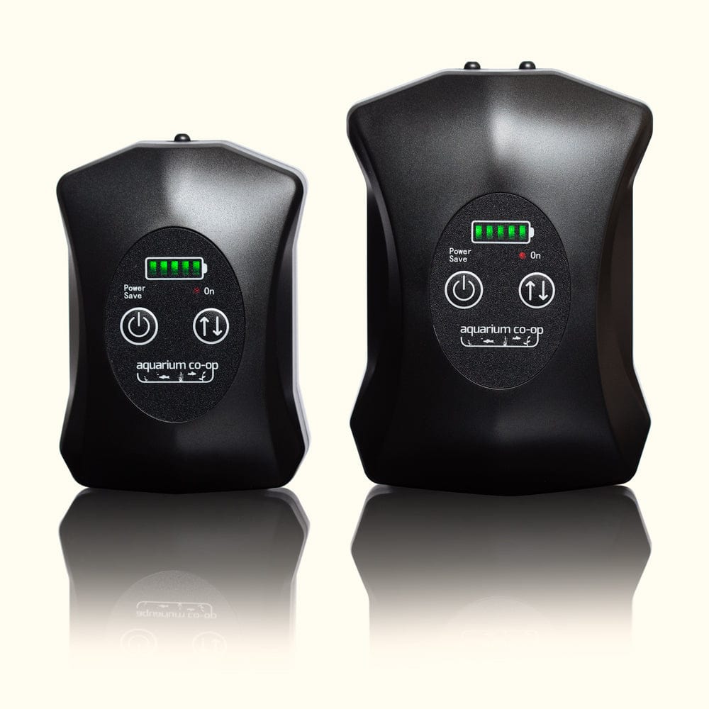

You could simplify that a touch by omitting the timer and just use one of these to drive an air stone/bubbler…
Having too many aquariums running to count, your fish want oxygen exchange which happens when the surface is agitated. And these are USB rechargeable.
Or look into any of the bait saver bubblers for 5Gal buckets as they do the same thing.

Looks like a neat device but my livewell will contain fish that are heading right to the freezer or deep fryer, not much catch and release going on for the species im targeting. My livewell has a recirculation and overflow line in place to keep the water fresh/cool just until i get back to the docks and throw them on ice.
