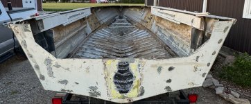

I’ve got the boat secured on my trailer with the bow winch post as well. I’m unsure if I should move the bunks aft to sit past the transom edge for further support, it would be an easy adjustment to make so I’ll hold off for later days to reaccess. Lately I’ve been using these nice days to be out chasing walleye on Lake Erie so my progress with this project has definitely slowed down.

My next step is going to be locating any loose or missing rivets and installing solid aluminum rivets. I’m thinking anything structural I’ll be using the normal solid rivets, and if there’s anything that’s purely to fill a hole with some sort of backing plate I’ll use some semi-tubular solid rivets to save the solids for places needing the additional strength. Using 5200 for extra sealing on the rivet shank as well.
I’ve got about 40-50 holes in the transom from where the PO had used blind rivets to attach a cover where the outdrive was. I’m thinking if I tig and fill any small holes that I won’t need in the future it will result in a cleaner look and avoid the river backing interfering with the wooden transom.
I’ve yet to decide on how I will properly seal and cover the outdrive hole but I’m leaning towards an aluminum plate that would cover as many small rivet holes as possible, and tig welding it to the original transom skin. This way I’ll be able to use the holes from the inside to tack the pieces together, and properly lay a bead all the way around to avoid to use of sealant and create a solid seal of aluminum to aluminum.
