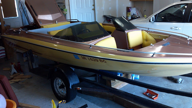

I received a present from the FedEx man yesterday morning. A very sought after part for the CVZ model, the hard 'convertible' bow cover! (Only available as an option, and only for 2 years!)
OH, You are a lucky man, YOU! And you're gonna keep us guessing where you found this treasure?
dorelse
Feb 24, 2003
624
Re: 1978 Glastron Carlson CVZ-18 Restore
I was hooked up by a classic glastron club member, he found it on a parts boat in MI that was listed on CL. Boat wasn't listed/identified correctly, and the owner was willing to part it out.

I ended up raising the floor about 3/4" when I put in the new one, so I had to trim down the bow seat bases as once I got the bow cover installed, it didn't fit correctly:
Better:
I was also able to find the slide hinges for the bow cover mounts:
