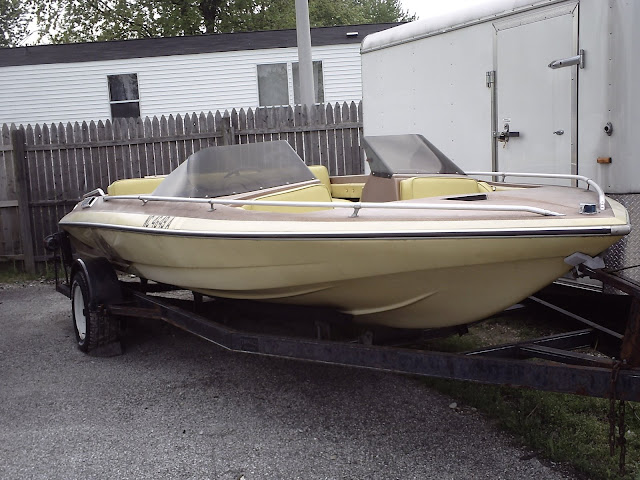

Just thought I'd add my current restore project into the mix. Here is my 1978 Glastron Carlson CVZ-18 that I just picked up. Price was right, and I love this model & design.
Here's a couple pictures to start with:
Picture%2520120.jpp
Not so factory seating:
No engine & water draining...
