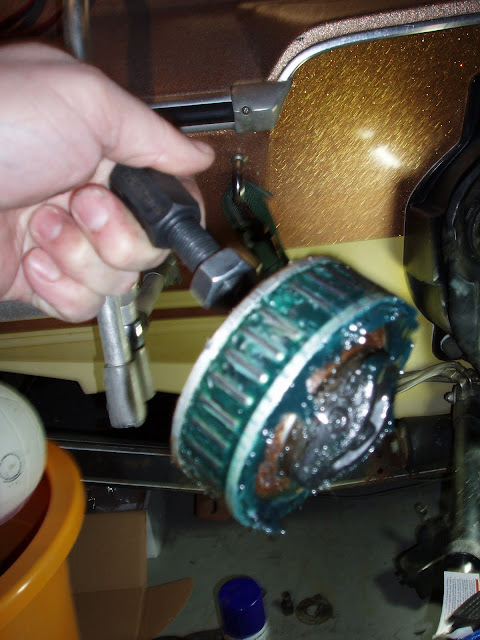

Well, I keep plugging away at the boat. I've been working on getting the outdrive hooked up, replacing gimbal bearing, bellows, etc.
I made my own gimbal bearing press so I wouldn't have to beat on the transom. I'm sure its up to it...but why? I just slowly cranked it in in about 15 mins:
A little PVC, a pipe fitting and a couple washers...and its a mini-press:

Nice job, looks like you made a trip to Ace.....I love it when I'm building something like that and they ask me if I need help....I don't even try to explain what I'm building, lol!
clockwatcher
Nov 8, 2009
289
Re: 1978 Glastron Carlson CVZ-18 Restore
I figured there was an easier way to install the bearing. I put mine in while the housing was on the bench/garage floor and it was still a pain.
That's exactly what I do. "Nope, I'm good, Thanks" is my standard response! Glad I'm not the only one.

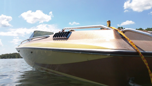

Some shots of the boat in the water:
And...video. Loving the sound of the motor! (Embedding video seems to be not working??? so its just a link for now.)
