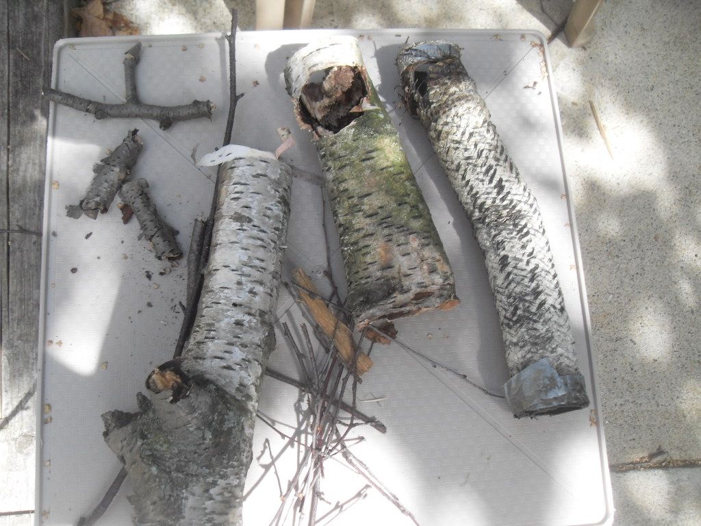

One of these is Not a rotted piece of white birch. It is my rotted gas tank fill tube. Once I get these hose's replaced I will drop the top. Easy to get at now.

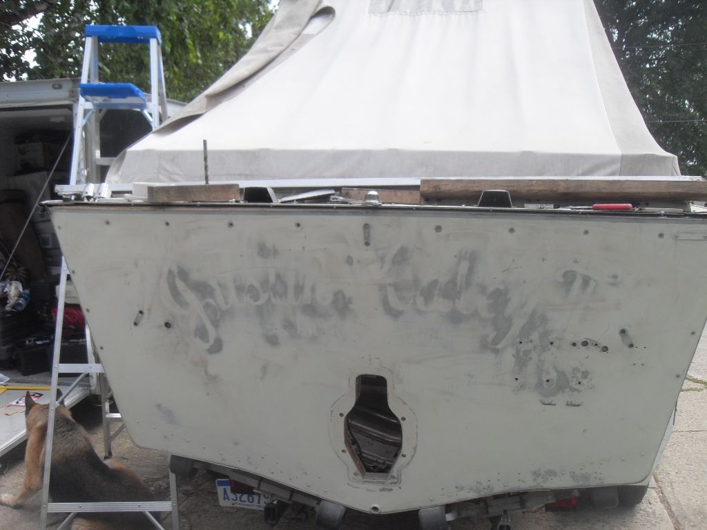

All new gas lines are on. Fill, feed, and vent. Lowered the top , everything is going into place.

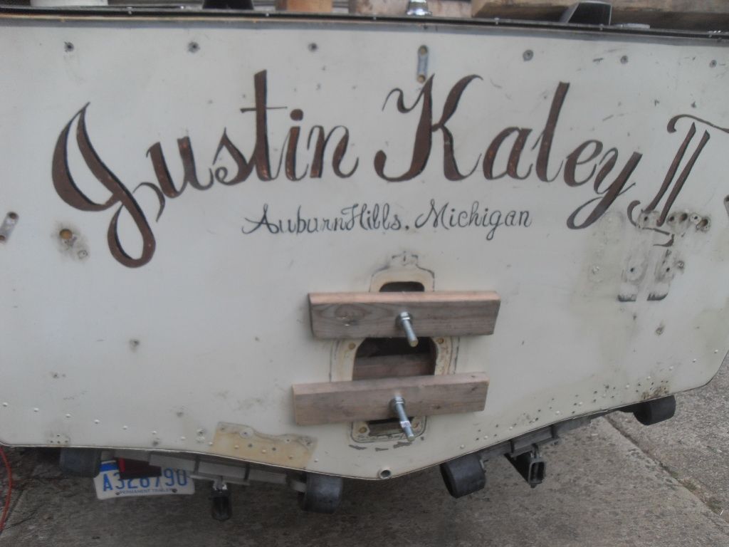

The transom assembly went in ok. Using a piece of hardwood for a guide when drilling paid off. Other than having to trim the keyhole a little everything went right in.
It's hard to believe how many things were taken apart to complete this job. Mostly time consuming things.
. The name will stay the same but the lettering will have to be replaced. Sander got away from me.:)

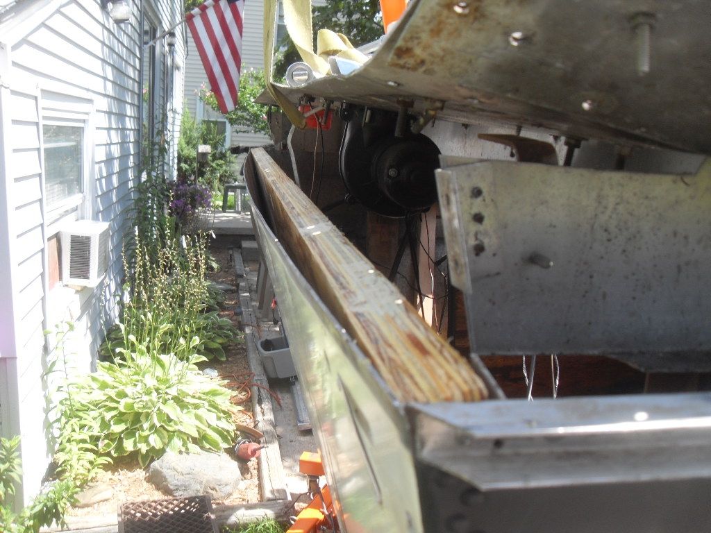

My bumper strips on each side of the boat have shrunk by 2 inches. I think I remember reading a post that mentioned that happening. Not sure what to do about that. Stretch it?
jbcurt00
Oct 25, 2011
25,288
Re: 1976 Starcraft Chieftain 22ft. Cuddy Cabin Transom replace.
Most of a good warm sunny day sitting outside & you might get the 2" of stretch. Someone on hand to pull it & keep it stretched & let you run the screw thru the end. May be better to make a new thru hole....
