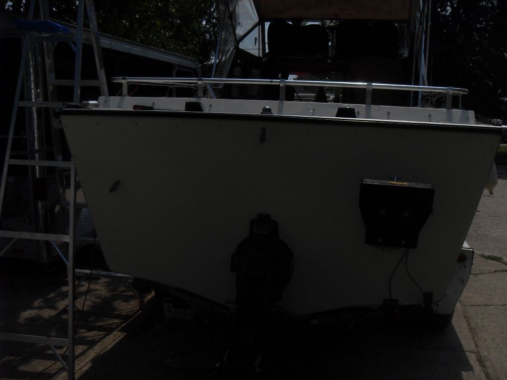

The steering has a line to it and a return. It works. There's a hole with threads that was throwing me a curve on the bottom of the reservoir I also could not get the motor to turn over. The neutral safety switch was broken. I bypassed it until I can get one. First I have a mess to clean up. Tools, wires, oil, and assemble the sides etc. inside. I know this job is not complete until I dunk it in the lake.
The pic is dark. Too much sun.

Hi Justin, Photobucket will let you edit your photos for things like brightness. - Grandad
