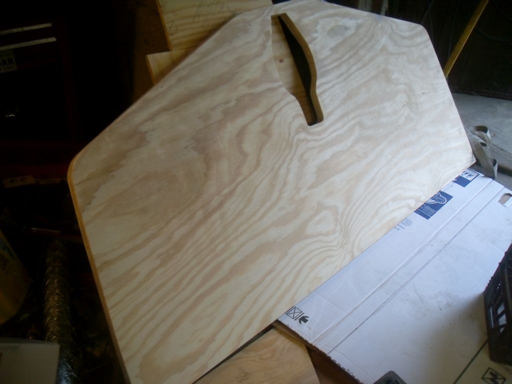

That's some fine looking ply you got hold of there. I love the look and feel of 7 layer 3/4 marine grade, nothing else like it. I used marine silicone to seal everything I thought I might want to take apart again someday, (thru hull fittings, transom bolts, motor bolts) everything else got some 5200.

Transom board is in and fits. Still having problems with photo's.
