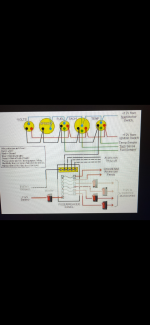

I believe I have it all wired up and all works as should. I actually used 2 wiring diagrams off the web, if anybody can find them useful.
I certainly did
