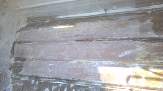

Doom:
It's not alot but it's progress. The 24 grit resin discs work really good but they are almost to aggressive to use inside the strakes since there are a couple tight corners. I think I will use flap discs there instead.

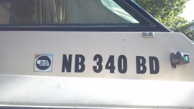

Another interesting thing, the boat was last registered in 1985, that means it was only 12 years old when it was put away. If it would have been stored a little better all this work probably wouldn't be necessary. Also check out the cool navigation light. There is one on each side.

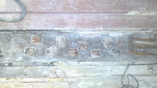

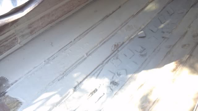

Quick question; in the bottom of the hull are several, randomly scattered 1/2" thick 4x4 inch wooden blocks. I'm almost certain they are there for added support. I will be replacing these as I'm sure the factory put them there for a reason. I'm just wondering if I should try to put them back as close to were they were from the factory or just randomly scatter them as they appear to be.
I got some cut out, you can see the outlines of them:

Looks like some form of ancient alien hieroglyphs...???:eek:...or maybe a code of some kind...:rolleyes:
They could have been utilized to help absorb vibration...I don't know, but couldn't you just replace them with a solid piece of glassed in ply???
Hmmm, very interesting...curious to see what the more knowledgeable dudes say about this...
That's actually all they are, ply that was sprayed over with the chopper gun. It seemed like they were sealed really well but there was only one that wasn't wet and rotten.

I think the blocks could be put back like the factory did it. Just in a random order. I would try to put back as many as they did.

...check out the cool navigation light. There is one on each side.
Those are pretty cool lookin' ...
Pretty amazing how some boats get barely run and put away.
Progress looks good.

Those are pretty cool lookin' ...Pretty amazing how some boats get barely run and put away.
Those lights look like an air filter snout for a motorcycle... Cool.
