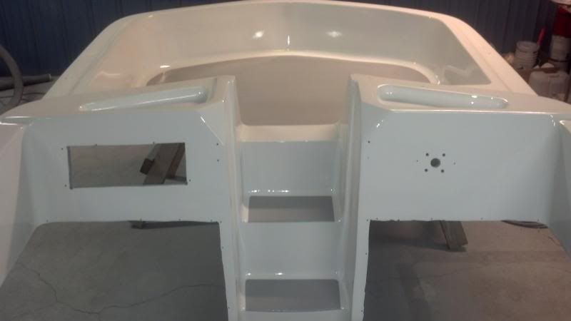

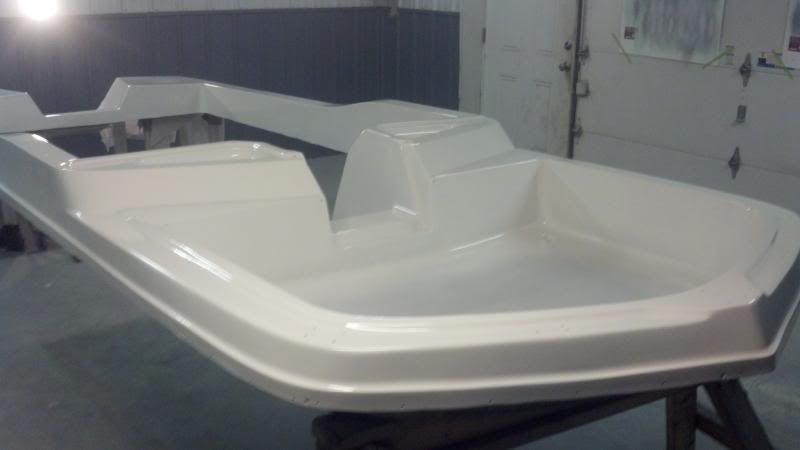

So, I've been busy fairing the cap, filling holes, filling crazed gelcoat, etc.
So, to make a long story short, repaired the cap, moved the splash pan forward, block sanded the gelcoat as the factory woven roving "prints through" over the years. Epoxy prime, fill microscopic crazing, sand, re epoxy prime then paint...
Here she is in epoxy primer...
About 4 coats of off white Nason Fulthane single stage...
Splash pan moved forward. You can see how thick the glass is now by looking at the drain hole. About 5 layers of 1708 then epoxy SM fairing compound. I moved the drain hole off of the transom and over to the side. That way, we won't have 2" of water sitting in it at all times and one less hole in the transom.
She's not street rod perfect but you can only do so much with this wavy fiberglass. I was using a handheld broom to sweep and knocked a hole through gelcoat on the dash area...cheaply made boat.
Next up, let this all cure then Interlux Interdeck the gunwhales, bow, and rear deck.
The windshield is restoring like new thanks to the Novus system(iboats search engine). Should have her almost done except for accessories before Jan 1st.

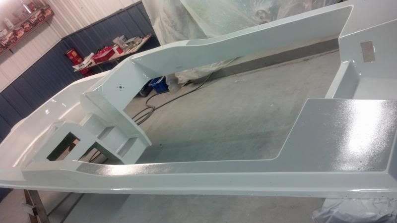

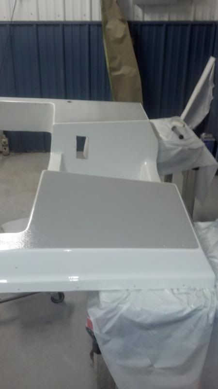

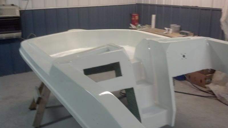

Well today I was able to tape off, and lay down the Interlux Interdeck with a nappy nap roller. I highly suggest the 3M fine line over just the 3M green tape. I noticed some miniature crazing in the bow area that I missed that showed up in the paint. Oh well. Here are some pics...
Now to bring the hull around, finish the flooring and reinstall the cap.
