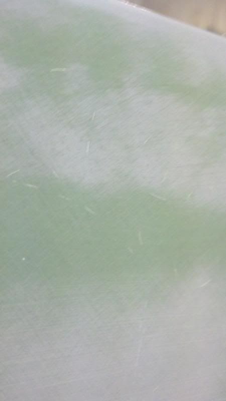

Well, as an update here's a pick of some of these imperfections in the hull. In this photo, they are filled..
I looked at my fiberglass book again and wouldn't you know, word for word in the caption. Good! I'm on the right track...
Dialing in my Iwata. It's been sooo long since I've done any of this stuff, and I never got particularly good at it. I'm so thankful for the internet.
Got a few coats of the epoxy primer on without a single run, phew! If this were a street rod, never mind...it isn't. This boat is so poorly built from a perfectionists standpoint that I'm hoping to just shoot right over this. There are some light sanding scratches still visible but I think she'll be a nice "5 footer". There are waves, low spots, wavy chine lines, lots of voids(I filled all I could find) in the boat. I'm getting burnt out...
Giving it about 6 hours at 80 degrees and hoping to shoot some color tonight.

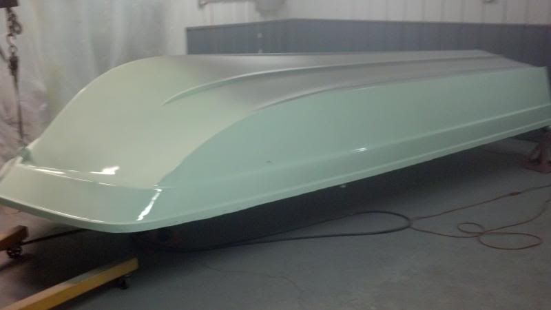

That came out great jc....theres no reason to get a boat perfect, especially the bottom and sides of a utility boat...its not like its going to barret jackson or something :)
Save your energy for the cap, which is what you'll be seeing most anyway.
Spraying is like riding a bike, comes right back to you!

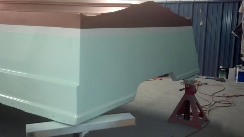

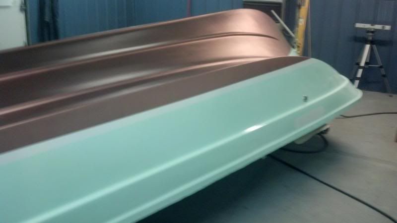

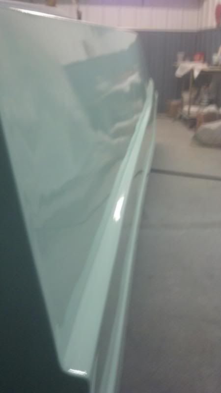

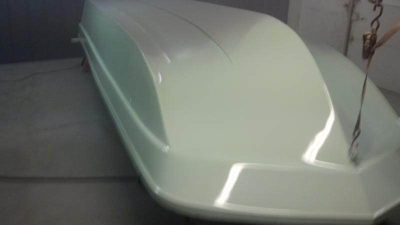

Thanks fellas! Well, I'm just on cloud nine right now. The color is a little darker than the internet can portray but my wife absolutely nailed(choirs singing) the color choice. I'll put a couple drops in the cap's white paint of this seafoam-ish green when I spray it.
There are waves to the structure of the boat as you can see, but not a single run! A pro painter would have gone a little wetter, but I wanted to play it safe...
This one's a little blurry...
I only went so far up the keel due to the bottom paint...
I am just so excited!!! So I have a couple of questions.

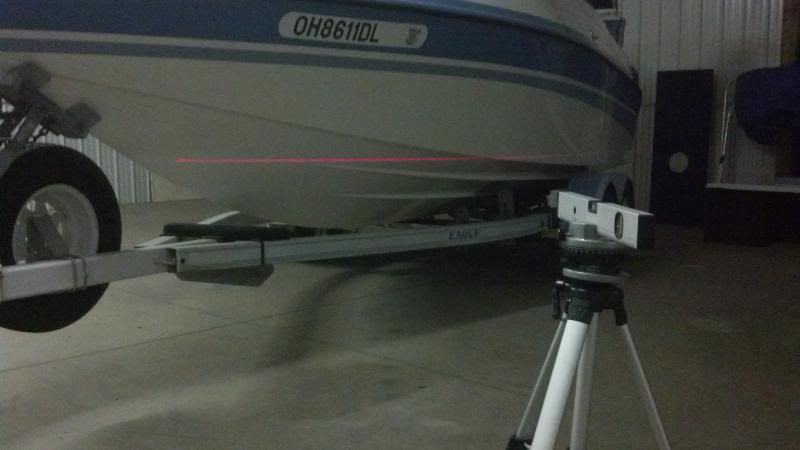

3) I have this generic laser set up to hopefully mark off some lines with 3M fine line tape...is that pretty straight forward? how long to tape Nason fulthane? Nothing useful on the tech sheet. Anyone knowledgeable in taping for boot stripes or boat numbering background in white? Scuff and shoot anytime?

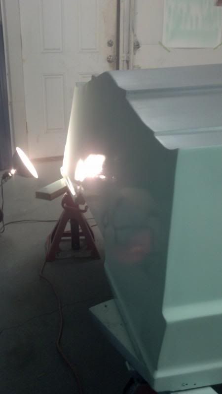

4) When can I cut the heat for paint cure? say, down to 50 degrees?

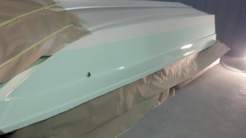

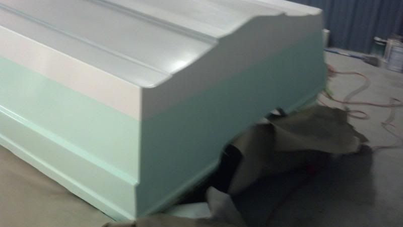

Well, didn't get any sleep last night. Which is normal prior to paint day. The green has been curing at 70 for 36 hours, so I broke out the cheapo laser and laid out the 3M 218 fine line tape to the predetermined/pre-paint measurements. The old lines on the boat were 3/4" off from side to side. I just can't believe that the factory could've been that "non detail oriented" (lazy).
I chose an off or grayish white. Sometimes the white on a freshly painted tu-tone boat looks too plain and a little too white(IMO) and this should bridge the color gap with the gray, Interlux Interdeck non skid that's going on the flat areas of the cap.
After the final coat, I waited 20 minutes and pulled the 3M tape downward and back on itself at a 45 degree angle...Perfect! I couldn't believe it kept such a crisp line. I'll wait until Wednesday to apply the bottom paint which will make this a 1 1/2" wide boot stripe when finished.

"I sure hope I don't screw this up. Any compatibility issues with the Bottom paint going over Lacquer sensitive(for a couple of days anyway) 2K urethane that is still curing?"
As long as it gassed off, you should be ok with a one part product over a 2k...the other way around (2k over 1 part) can cause more issues as the weakest link would be the tie coat...basically what you have it the epoxy primer as the barrier coat to prevent blistering and for maximum adhesion....the small amount of fogged AU shouldnt cause a problem after 36 hours. Make sure you scuff all the surfaces of primer before putting on the vc17...as you wont get a chemical bond so you need a mechanical one.

MHj, No, the bottom line is a Nason single stage paint. It's just a little "off white, but it's real paint just like the green :) The whole cap will be this same white, but the gun whales and the rear deck on either side of the outboard will have a gray Interlux non skid like sailboats get. Thanks for the compliments! I was hoping that all the stainless and aluminum on this boat would pop against the green. Kind of going for a mini offshore boat look capable of doing some of my river work. The top should look like those center console offshore boats with the small hard top over the console(if that makes sense?)

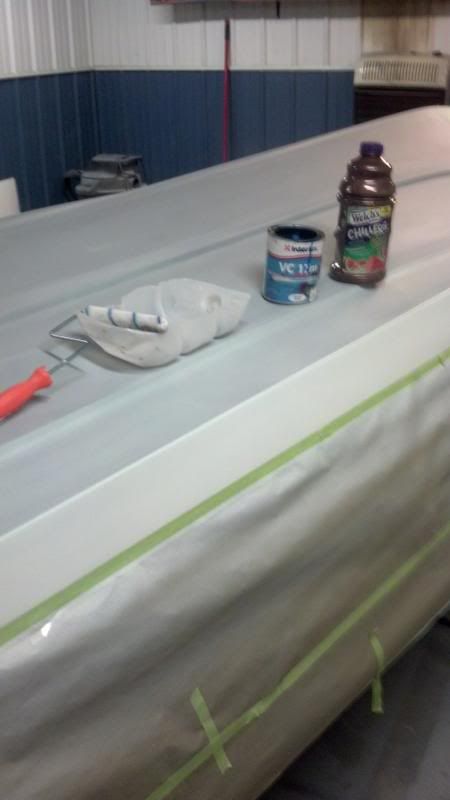

So, sanded everything with 400 grit. Since VC is solvent based, not hardener based, They say you can shake her up and pour out what you need. Keeping the unused for up to a year. I bought 3 quarts from iboats...ooops! but only used one. FYI, green 3M tape WILL NOT hold this stuff back. (Not with the boat upside down anyways:) ) Must use a fineline first then green up to it...

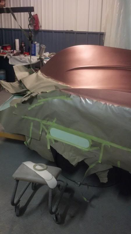

Shot my number background today while potsing around the shop. I didn't really plan. Did a 3" tall strip for 2" tall letters using a template.
Everything came out pretty good. I think I doubled the salvage value of the boat with all that copper. Maybe they'll leave the wiring alone and just take this hull. This should turn blue when it hits the water.
